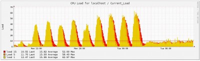

From the testing today I am almost certain there is something going on with Nagios version 4. I installed 3.5.1 this morning and have let it run the whole day and no spikes at all like in 4.0.6
I have attached the graph showing this. All those spikes are with version 4.0.6 installed and running. From between Tue 00:00 and Tue 06:00 I compiled and installed 3.5.1 (No embedded perl) and you can clearly see that the load is as it should be, pretty constant with very little fluctuation. The config file is the same for both versions.

We were not aware of this. I am attempting to reproduce the issue. My curiosity concerning processes with heavy load was due to my attempt to reproduce the environment. My tests currently do not show these spikes. It could be related to one of your checks and core 4, a core 4 config option, or a problem with core 4 itself. The next time load starts spiking, can you get a few top and ps outputs?

From the start I have checked top and ps outputs and there is nothing untoward. Being a VM I can monitor all the different aspects of it, and CPU utilization, Disk and Network show no change. Everything looks like it is ticking along as normal and nothing changes. All the checks run at their regular intervals, none are in a hung state or zombied. The only metric I can't get from inside the VM is what is happening in memory. Something makes me think there is some sort of flush happening. Something being cleared out of a cache. So unfortunately top and ps don't show anything that points in a particular direction to the cause of the issue.
Just so you are aware. This is a server running about 4500 checks over 48 devices with check intervals between 5 and 10 minutes. This is the only time we start seeing it (well when there are a thousand or more checks). When there are only a few checks it is not visible at all.
