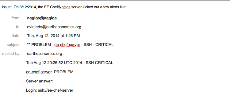

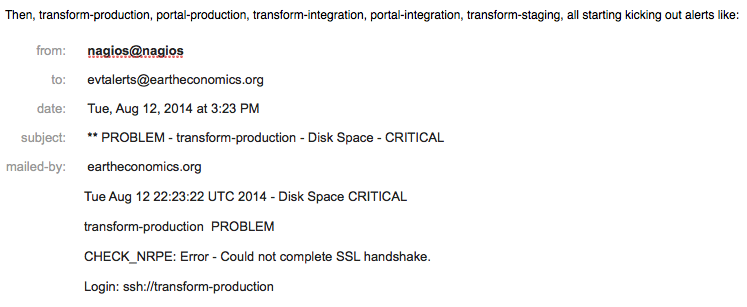

Issue: On 8/12/2014, Our Chef/Nagios server kicked out a few alerts like the ones shown in the attached (alert) screen-shots. The "disk space – critical" message started showing up, around every 30 minutes or so, on the problem hosts.
I next ran "df -h" on a number of the hosts that were kicking out the alerts and found that disk space was fine on all of them. So, it seemed, at the very least, we weren't dealing with a true emergency.

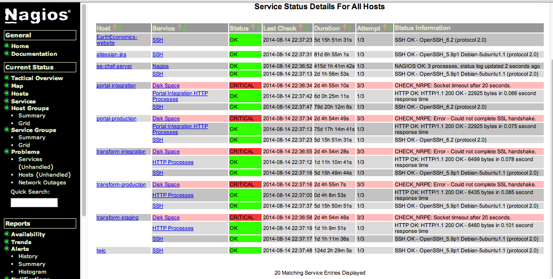

The "Service Status" screen-shot shows what we're now getting. I'm wondering if anyone can help me figure out why CHECK_NRPE is suddenly failing.

I'm new to Chef, so I'm not sure exactly what I need to be posting here. Where you see "atlassian-jira" among the hosts on the "Service Status" page that I showed, I did a "chef-client" run. Then, I searched the output for nrpe.cfg. This yielded:
