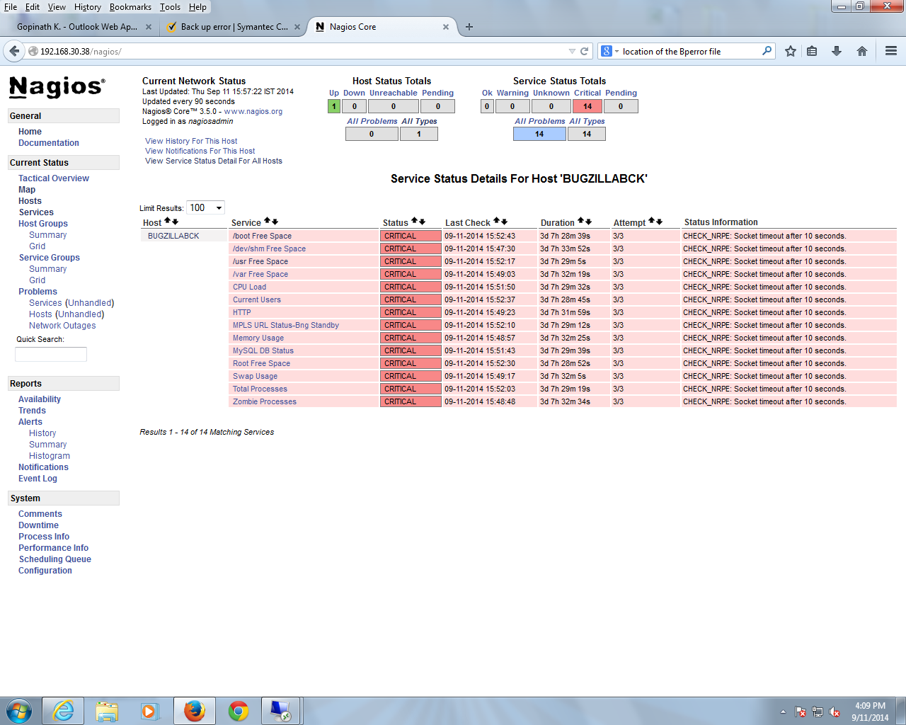

My RHEL server is connected to Nagios server and it has running 14 services. All services status in Nagios server is showing as "CHECK_NRPE: Socket timeout after 20 seconds. "
Action done :
1. netstat -at | grep check_nrpe - Client side it's listening.
Kindly help me to resolve this.
Reference attachment

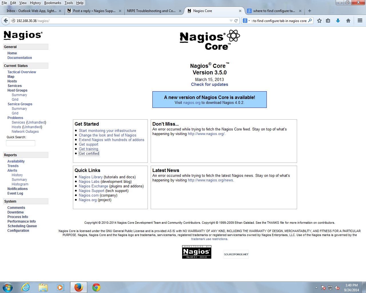

Let me know where i can get "configure" Tab on my nagios core home page.
configure Tab
configure Tab
Posts: 7698
Re: CHECK_NRPE: Socket timeout after 20 seconds.
Post by slansing »
You cannot get it in Core, as I was mentioning, the document was written for Nagios XI, but the changes you can make to commands, services, and generally everything mentioned in it, can be done with Core. The only thing is you need to do them manually with your .cfg files instead of using the web frontend that XI gives you.
