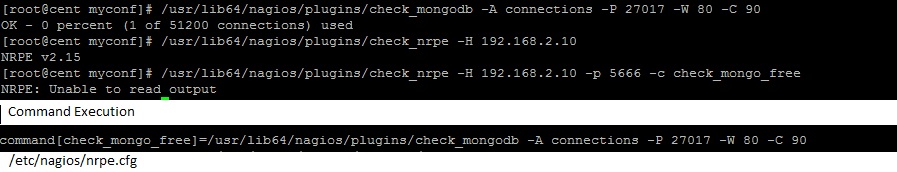

command[check_mongo_free]=/usr/lib64/nagios/plugins/check_mongodb -A connections -P 27017 -W 80 -C 90
allowed_hosts=127.0.0.1,192.168.2.10
4) both commands show same results on nagios server
OK - 0 percent (1 of 51200 connections) used
sudo -u nagios /usr/lib64/nagios/plugins/check_mongodb -A connections -P 27017 -W 80 -C 90

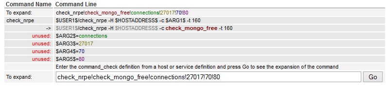

command_name check_nrpe
command_line $USER1$/check_nrpe -H $HOSTADDRESS$ -c $ARG1$ -t 160
command_name check_mongodb
command_line $USER1$/check_mongodb.py -H $HOSTADDRESS$ -A $ARG1$ -P $ARG2$ -W $ARG3$ -C $ARG4$
host_name CENT
service_description Mongo Free Connections
check_command check_nrpe!check_mongo_free!connections!27017!70!80
