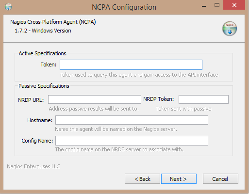

We have Nagios Core setup on one of our servers, my boss did the installation. I am trying to setup Nagios Cross Platform Agent (NCPA) on my desktop. There is a parameter "Config Name" that I do not know what this value is. How/Where do I get this value on Nagios Core is installed on our server? I attached the screen shot of needed parameters to install NCPA. Config Name is the last parameter in the screen shot.

If you are using NRDS on your Core server, that is where you would place the name of the saved configuration you wish to use for this server. If you do not plan to use NRDS then you can leave that blank and change it later in the flat configuration file.

As slansing mentioned, config name and everything except token is optional and only used for nrdp\nrds. If you are planning to use just active checks with check_ncpa, you do not need the passive section at all, and it may be left entirely blank without worry.

These are the details of the sending machine. This is how Nagios associates these check results with services.

IF NRDP (not NRDS) was installed, a config file for it would exists here:clombardo wrote:I'll have to check with my boss if he installed NRDS. Is there a way to check via linux command line?
/usr/local/nrdp/server/config.inc.php
The Config Name and Host name are not stored on the NRDP receiving server.clombardo wrote:Now if we have NRDS installed there would be a Config Name there like you said. Where would I find the Config Name?
Here is examples from the nagios.log when these services do not exist.
[1421279817] Error: Got check result for service 'cpu usage' on host 'My Config Name win7-01'. Unable to find service
[1421279817] Error: Got check result for service 'memory usage' on host 'My Config Name win7-01'. Unable to find service
[1421279817] Error: Got check result for service 'swap usage' on host 'My Config Name win7-01'. Unable to find service
