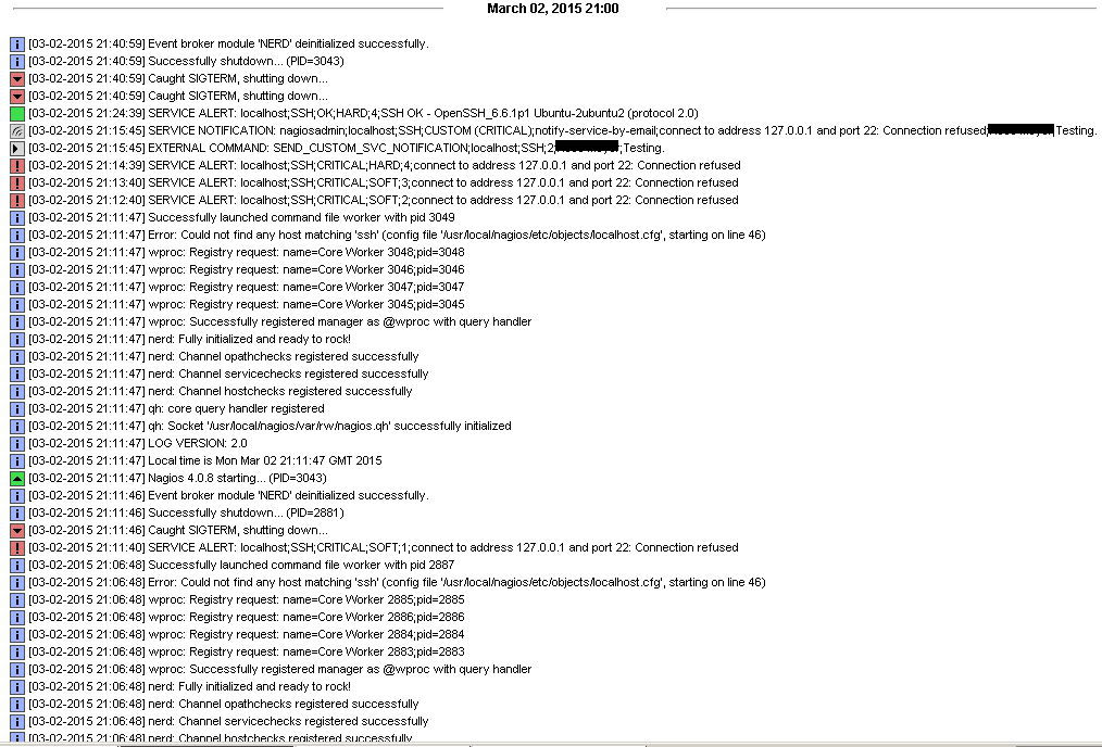

Here is the event log if that helps at all?

Can you try to run the following from the commandline of your nagios server logged on as nagios and share with us the output, as well as maybe the last 20 or so lines of /var/log/maillog. Make sure to obfuscate private data from that log file.
