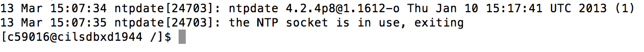

rockxd
Posts: 26
Joined: Fri Feb 27, 2015 10:01 am
Re: Requesting Help Configuring check_ntp_time
Post by rockxd »
I get the following:

jdalrymple
Skynet Drone
Posts: 2620
Post by jdalrymple »
This just means that NTP is functioning on that server, which is good :)

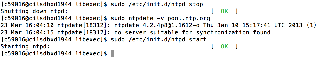

rockxd

Post by rockxd »
It is saying that my server is not suitable for synchronization.

jdalrymple
Skynet Drone
Posts: 2620
Can you ping pool.ntp.org?
Usually that message means either the ntp server is unreachable, or your clock skew is too great to correct it.
It might also be worthwhile to checkout your ntp.conf and make sure we even have some servers configured:
[jdalrymple@localhost ~]$ sudo grep ^server /etc/ntp.conf
server 0.centos.pool.ntp.org iburst
server 1.centos.pool.ntp.org iburst
server 2.centos.pool.ntp.org iburst
server 3.centos.pool.ntp.org iburst
