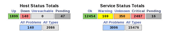

We have successfully upgraded to Nagios 4.x but we are having high cpu load issue. Here are the details. Could you please advise.
1. cpu load
12:12:46 up 1 day,  3:40,  2 users,  load average: 237.30, 250.30, 258.91
2. latency status
Service Check Execution Time:	0.00 / 80.34 / 14.126 sec
Service Check Latency:	0.00 / 1186.89 / 1055.388 sec
Host Check Execution Time:	0.00 / 44.84 / 11.675 sec
Host Check Latency:	0.00 / 1098.06 / 1028.665 sec
# Active Host / Service Checks:	1846 / 13869
# Passive Host / Service Checks:	240 / 1607
3. Host details.

we have successfully upgraded to Nagios 4.x but we are facing high cpu load in the server. Below are the details. Could you please let me know what needs to be checked further.
1. cpu load
2. latency status
3. Host details
 attached
1. cpu load
2. latency status
3. Host details.
attached

What distribution is Nagios Core running on?
cat /etc/*release*
uname -a
Is this load spike ongoing? Is there a particular process causing it? How often does the server spike if it's not constant?
ps aux
top
How did you upgrade the Core machine - did you encounter any issues?

Please find the details below.
No distribution. Its stand alone
cat /etc/*release*
LSB_VERSION=base-4.0-amd64:base-4.0-noarch:core-4.0-amd64:core-4.0-noarch:graphics-4.0-amd64:graphics-4.0-noarch:printing-4.0-amd64:printing-4.0-noarch
cat: /etc/lsb-release.d: Is a directory
Red Hat Enterprise Linux Server release 6.4 (Santiago)
cpe:/o:redhat:enterprise_linux:6server:ga:server
uname -a
Linux us25nagios002 2.6.32-358.el6.x86_64 #1 SMP Tue Jan 29 11:47:41 EST 2013 x86_64 x86_64 x86_64 GNU/Linux
Yes ongoing. Its not for particular process. Its 200+ all the time.

nagios    3749  0.8  0.0      0     0 ?        Z    10:08   0:00 [submit_nagios_e] <defunct>
nagios    3759  0.8  0.0      0     0 ?        Z    10:08   0:00 [submit_nagios_e] <defunct>
nagios    3769  1.4  0.0 161596  6416 ?        S    10:08   0:00 /usr/bin/perl -w /nagiosfs/libexec/submit_nagios_events_to_omnibus.pl SDC_CH2BL03_ESX.pod1.iaas.ibm check vmware vmfs 2 (Service che
nagios    3778  0.2  0.0   6408   648 ?        S    10:08   0:00 /bin/ping -n -U -w 60 -c 2 10.179.45.200
nagios    3783  0.1  0.0   6408   644 ?        S    10:08   0:00 /bin/ping -n -U -w 60 -c 2 10.179.48.33
nagios    3790  0.3  0.0      0     0 ?        Z    10:08   0:00 [check_nrpe] <defunct>
nagios    3797  0.8  0.0      0     0 ?        Z    10:08   0:00 [submit_nagios_e] <defunct>
nagios    3812  1.5  0.0 161596  6416 ?        S    10:08   0:00 /usr/bin/perl -w /nagiosfs/libexec/submit_nagios_events_to_omnibus.pl PROJECT_OFC-SW cpu load status 2 (Service check timed out afte
nagios    3815  0.1  0.0 109476   912 ?        S    10:08   0:00 /nagiosfs/libexec/check_ping -H 10.217.20.201 -w 3000.0,80% -c 5000.0,100% -p 2 -t 60
nagios    3816  0.8  0.0      0     0 ?        Z    10:08   0:00 [submit_nagios_e] <defunct>
nagios    3823  0.1  0.0   6408   648 ?        S    10:08   0:00 /bin/ping -n -U -w 60 -c 2 10.217.21.158
nagios    3837  0.2  0.0   6408   644 ?        S    10:08   0:00 /bin/ping -n -U -w 60 -c 2 10.179.214.210
nagios    3843  1.9  0.0 143264 10708 ?        R    10:08   0:00 /usr/bin/perl -w /nagiosfs/libexec/check_nwc_health -H 10.179.29.2 --community public --mode memory-usage --warning 85 --critical 90
nagios    3857  0.9  0.0      0     0 ?        Z    10:08   0:00 [submit_nagios_e] <defunct>
nagios    3865  1.4  0.0 161596  6420 ?        S    10:08   0:00 /usr/bin/perl -w /nagiosfs/libexec/submit_nagios_events_to_omnibus.pl pdc-bcc01-b2 check vmware cpu 2 (Service check timed out after
nagios    3953  0.3  0.0  38996  2180 ?        S    10:08   0:00 /nagiosfs/libexec/check_nrpe -H 10.217.252.161 -u -t 800 -c check_cpu_util -a 91 96 37
nagios    3959  1.6  0.0 161596  6416 ?        S    10:08   0:00 /usr/bin/perl -w /nagiosfs/libexec/submit_nagios_events_to_omnibus.pl S0I1PRFEPORA001.pr.asphsc.admin check_cpu_util 2 (Service chec
nagios    3960  1.0  0.0      0     0 ?        Z    10:08   0:00 [submit_nagios_e] <defunct>
nagios    3967  1.9  0.0 141152  8544 ?        R    10:08   0:00 /usr/bin/perl -w /nagiosfs/libexec/check_nwc_health -H 10.179.25.1 --community MyFidelity003 --mode hardware-health
nagios    3969  1.4  0.0 161596  6420 ?        S    10:08   0:00 /usr/bin/perl -w /nagiosfs/libexec/submit_nagios_events_to_omnibus.pl FBLTESTECL008.myfidelitybank.net Check Event ID 3417 2 (Servic
nagios    3975  1.7  0.0 161596  6380 ?        R    10:08   0:00 /usr/bin/perl -w /nagiosfs/libexec/submit_nagios_events_to_omnibus.pl vsphere140.myfidelitybank.net check vmware io 2 (Service check
nagios    3989  1.0  0.0      0     0 ?        Z    10:08   0:00 [submit_nagios_e] <defunct>
nagios    3991  1.8  0.0 161596  6420 ?        S    10:08   0:00 /usr/bin/perl -w /nagiosfs/libexec/submit_nagios_events_to_omnibus.pl NSWLNXVM34.NSWFIRE.NSW.GOV.AU log file messages warn status 2
nagios    3998  0.3  0.0      0     0 ?        Z    10:08   0:00 [sh] <defunct>
nagios    4002  1.6  0.0 161596  6424 ?        S    10:08   0:00 /usr/bin/perl -w /nagiosfs/libexec/submit_nagios_events_to_omnibus.pl SDC_CH1BL01_ESX.pod1.iaas.ibm check vmware runtime 2 (Service
nagios    4013  1.1  0.0      0     0 ?        Z    10:08   0:00 [submit_nagios_e] <defunct>
nagios    4015  1.7  0.0 161596  6424 ?        S    10:08   0:00 /usr/bin/perl -w /nagiosfs/libexec/submit_nagios_events_to_omnibus.pl eConnHelpDesk_Test_3001.myfidelitybank.net Check Event ID 5532
nagios    4017  1.8  0.0 161596  6400 ?        S    10:08   0:00 /usr/bin/perl -w /nagiosfs/libexec/submit_nagios_events_to_omnibus.pl us25nag010rmsra.hs.rochny.ibm.com Zombie_Process 3 wmax (60) c
nagios    4019  0.1  0.0 109476   912 ?        S    10:08   0:00 /nagiosfs/libexec/check_ping -H 10.179.142.163 -w 450.0,80% -c 500.0,90% -p 2 -t 60
nagios    4028  1.2  0.0      0     0 ?        Z    10:08   0:00 [submit_nagios_e] <defunct>
nagios    4030  0.3  0.0  38852  1268 ?        S    10:08   0:00 /nagiosfs/libexec/check_nrpe -n -H 10.179.100.38 -u -t 60 -c check_proc_syslogd
nagios    4037  1.1  0.0      0     0 ?        Z    10:08   0:00 [submit_nagios_e] <defunct>
nagios    4049  1.2  0.0      0     0 ?        Z    10:08   0:00 [submit_nagios_e] <defunct>
nagios    4064  0.3  0.0      0     0 ?        Z    10:08   0:00 [check_ping] <defunct>
nagios    4066  1.1  0.0      0     0 ?        Z    10:08   0:00 [submit_nagios_e] <defunct>
nagios    4074  1.2  0.0      0     0 ?        Z    10:08   0:00 [submit_nagios_e] <defunct>
nagios    4081  0.2  0.0  38852  1260 ?        S    10:08   0:00 /nagiosfs/libexec/check_nrpe -n -H 10.179.100.38 -u -t 60 -c check_messages_panic
nagios    4087  0.4  0.0  38852  1900 ?        S    10:08   0:00 /nagiosfs/libexec/check_nrpe -H 10.179.142.168 -p 5666 -t 60 -c CheckEventLog -a file=Application file=System file=Security debug=tr
nagios    4093  2.1  0.0 132124  7788 ?        R    10:08   0:00 /usr/bin/perl -w /nagiosfs/libexec/check_snmp_process.pl -C public -t 60 -H 10.217.14.177 -n xenbus -w 0 -c 0
nagios    4096  2.1  0.0 130588  8368 ?        R    10:08   0:00 /usr/bin/perl -w /nagiosfs/libexec/check_vmware_api -H 10.217.252.198 -f /nagiosfs/monitor/ESX/vmwarepass -l cpu -s usage -w 85 -c 9
nagios    4107  1.8  0.0 159360  5884 ?        R    10:08   0:00 /usr/bin/perl -w /nagiosfs/libexec/submit_nagios_events_to_omnibus.pl nswlnxvm53.nswfire.nsw.gov.au check_load 2 (Service check time
nagios    4155  1.1  0.0      0     0 ?        Z    10:08   0:00 [submit_nagios_e] <defunct>
nagios    4158  0.5  0.0  38996  2192 ?        S    10:08   0:00 /nagiosfs/libexec/check_nrpe -H 10.217.42.127 -u -t 800 -c check_cpu_util -a 91 96 37
nagios    4162  1.8  0.0 161596  6412 ?        S    10:08   0:00 /usr/bin/perl -w /nagiosfs/libexec/submit_nagios_events_to_omnibus.pl ihspreprod02-Dal06.maps.ibmcloud.com check_cpu_util 2 (Service
nagios    4164  0.5  0.0      0     0 ?        Z    10:08   0:00 [check_nrpe] <defunct>
nagios    4166  1.4  0.0      0     0 ?        Z    10:08   0:00 [submit_nagios_e] <defunct>
nagios    4168  0.5  0.0      0     0 ?        Z    10:08   0:00 [check_nrpe] <defunct>
nagios    4181  1.2  0.0      0     0 ?        Z    10:08   0:00 [check_port.pl] <defunct>
nagios    4182  0.2  0.0      0     0 ?        Z    10:08   0:00 [check_ping] <defunct>
nagios    4184  2.2  0.0 129924  7744 ?        R    10:08   0:00 /usr/bin/perl -w /nagiosfs/libexec/check_vmware_api -H 10.217.35.6 -f /nagiosfs/monitor/ESX/vmwarepass_boskalis -l io -s write -w 40
nagios    4212  0.2  0.0 109476   908 ?        S    10:08   0:00 /nagiosfs/libexec/check_ping -H 10.179.142.161 -w 450.0,80% -c 500.0,90% -p 2 -t 60
nagios    4221  0.4  0.0      0     0 ?        Z    10:08   0:00 [sh] <defunct>
nagios    4224  0.2  0.0      0     0 ?        Z    10:08   0:00 [sh] <defunct>
nagios    4225  0.4  0.0      0     0 ?        Z    10:08   0:00 [check_nrpe] <defunct>
nagios    4236  1.6  0.0      0     0 ?        Z    10:08   0:00 [submit_nagios_e] <defunct>
nagios    4247  1.9  0.0 128788  4536 ?        R    10:08   0:00 /usr/bin/perl -w /nagiosfs/libexec/submit_nagios_events_to_omnibus.pl NSWSAP07.nswfire.nsw.gov.au Disk_Inodes_Usage 0 DISK OK 0
nagios    4248  0.6  0.0  38996  2192 ?        S    10:08   0:00 /nagiosfs/libexec/check_nrpe -H 10.217.20.253 -u -t 800 -c check_cpu_util -a 91 96 37
nagios    4260  1.8  0.0 129448  4992 ?        R    10:08   0:00 /usr/bin/perl -w /nagiosfs/libexec/submit_nagios_events_to_omnibus.pl sftbkup001.pxc.peroxychem.com Disk_Filesystem_Usage 2 CHECK_NR
nagios    4261  0.5  0.0  38996  2176 ?        S    10:08   0:00 /nagiosfs/libexec/check_nrpe -H 10.217.20.252 -u -t 800 -c check_cpu_util -a 91 96 37
nagios    4262  1.6  0.0      0     0 ?        Z    10:08   0:00 [submit_nagios_e] <defunct>
nagios    4272  2.0  0.0 131624  5084 ?        R    10:08   0:00 /usr/bin/perl -w /nagiosfs/libexec/submit_nagios_events_to_omnibus.pl wdc01prdesx0001.peroxychem.net check vmware runtime 2 (Service
nagios    4273  1.7  0.0 128788  4464 ?        S    10:08   0:00 /usr/bin/perl -w /nagiosfs/libexec/submit_nagios_events_to_omnibus.pl A_CMallBakingHallCam PING 2 PING CRITICAL - Packet loss = 0%,
nagios    4278  1.1  0.0  78780  3188 ?        S    10:08   0:00 send-mail -i imtaskid@in.ibm.com
nagios    4283  2.3  0.0 129528  7392 ?        R    10:08   0:00 /usr/bin/perl -w /nagiosfs/libexec/check_vmware_api -H 10.217.42.10 -f /nagiosfs/monitor/ESX/vmwarepass_fire_rescue -l cpu -s usage
nagios    4296  1.6  0.0 128788  4460 ?        S    10:08   0:00 /usr/bin/perl -w /nagiosfs/libexec/submit_nagios_events_to_omnibus.pl KoforiduaPreVault-BackExitCam.myfidelitybank.net PING 2 PING C
nagios    4301  0.3  0.0      0     0 ?        Z    10:08   0:00 [check_ping] <defunct>
nagios    4302  0.5  0.0  38852  1892 ?        S    10:08   0:00 /nagiosfs/libexec/check_nrpe -H 10.217.21.41 -u -t 800 -c check_cpu_util -a 91 96 37
nagios    4304  1.3  0.0 132736  4380 ?        S    10:08   0:00 /usr/bin/perl -w /nagiosfs/libexec/check_port.pl -H 10.217.41.141 -p 8879
root      4307  0.0  0.0  97876  3908 ?        Ss   08:59   0:00 sshd: cborah [priv]
nagios    4309  2.0  0.0 128912  4456 ?        S    10:08   0:00 /usr/bin/perl -w /nagiosfs/libexec/submit_nagios_events_to_omnibus.pl jslpreprod02-Sjc01.maps.ibmcloud.com memcached response time 0
nagios    4311  2.1  0.0 127548  5404 ?        R    10:08   0:00 /usr/bin/perl -w /nagiosfs/libexec/check_vmware_api -H 10.217.42.24 -f /nagiosfs/monitor/ESX/vmwarepass_fire_rescue -l mem -s usage
nagios    4312  1.6  0.0      0     0 ?        Z    10:08   0:00 [submit_nagios_e] <defunct>
nagios    4316  1.9  0.0 128912  4532 ?        R    10:08   0:00 /usr/bin/perl -w /nagiosfs/libexec/submit_nagios_events_to_omnibus.pl nbcsanswpo02 check brocade FCports Status 0 FC ports OK : FC P
nagios    4318  1.8  0.0 128788  4532 ?        R    10:08   0:00 /usr/bin/perl -w /nagiosfs/libexec/submit_nagios_events_to_omnibus.pl FBLIBSVR001.myfidelitybank.net Check Event ID 3013 0 Eventlog
nagios    4319  1.0  0.0  78780  3168 ?        S    10:08   0:00 send-mail -i imtaskid@in.ibm.com
nagios    4321  1.8  0.0 128788  4536 ?        R    10:08   0:00 /usr/bin/perl -w /nagiosfs/libexec/submit_nagios_events_to_omnibus.pl usrd11vol10008.vol.rtp.ssm.sdc.gts.ibm.com db2sysc Process 0 P
nagios    4325  2.1  0.0 159480  5384 ?        R    10:08   0:00 /usr/bin/perl -w /nagiosfs/libexec/submit_nagios_events_to_omnibus.pl KVM1-us25nag010rmsra Zombie_Processes 2 Connection refused or
nagios    4329  0.4  0.0      0     0 ?        Z    10:08   0:00 [check_ping] <defunct>
nagios    4332  2.0  0.0 128912  4452 ?        S    10:08   0:00 /usr/bin/perl -w /nagiosfs/libexec/submit_nagios_events_to_omnibus.pl usrd11vol20009.vol.rtp.ssm.sdc.gts.ibm.com Log File has reache
nagios    4335  0.1  0.0   6408   644 ?        S    10:08   0:00 /bin/ping -n -U -w 60 -c 2 10.179.142.161
nagios    4338  1.8  0.0      0     0 ?        Z    10:08   0:00 [submit_nagios_e] <defunct>
nagios    4342  1.0  0.0  78780  3176 ?        S    10:08   0:00 send-mail -i imtaskid@in.ibm.com
nagios    4344  2.0  0.0 128920  4520 ?        R    10:08   0:00 /usr/bin/perl -w /nagiosfs/libexec/submit_nagios_events_to_omnibus.pl wdc01prdesx0003.pxc.peroxychem.com All Other Drive Space 2 Con
nagios    4345  2.0  0.0 128788  4452 ?        S    10:08   0:00 /usr/bin/perl -w /nagiosfs/libexec/submit_nagios_events_to_omnibus.pl wdc01-nr-ecom-prod-live-app-srch-app03.sl.newellco.com PING 0
nagios    4347  2.0  0.0 128788  4536 ?        R    10:08   0:00 /usr/bin/perl -w /nagiosfs/libexec/submit_nagios_events_to_omnibus.pl INFRA-108.asphsc.priv PING 0 PING OK - Packet loss = 0%, RTA =
nagios    4348  1.8  0.0 129316  4960 ?        R    10:08   0:00 /usr/bin/perl -w /nagiosfs/libexec/submit_nagios_events_to_omnibus.pl FBLMYHRSVR002.myfidelitybank.net C:\ Drive Space 3 Free disk s
nagios    4349  1.7  0.0      0     0 ?        Z    10:08   0:00 [submit_nagios_e] <defunct>
nagios    4352  1.6  0.0      0     0 ?        Z    10:08   0:00 [submit_nagios_e] <defunct>
nagios    4356  2.0  0.0 128788  4452 ?        S    10:08   0:00 /usr/bin/perl -w /nagiosfs/libexec/submit_nagios_events_to_omnibus.pl nswmsvm131.nswfire.nsw.gov.au port 12489 status 0 PORT 12489 O
nagios    4360  1.9  0.0      0     0 ?        R    10:08   0:00 [submit_nagios_e]
nagios    4365  2.0  0.0 128788  4452 ?        S    10:08   0:00 /usr/bin/perl -w /nagiosfs/libexec/submit_nagios_events_to_omnibus.pl sdmprodwebl1.sdm.local Log File AdminServer 0 OK: Found 0 line
nagios    4368  0.6  0.0      0     0 ?        Z    10:08   0:00 [sh] <defunct>
nagios    4373  0.9  0.0      0     0 ?        Z    10:08   0:00 [check_nrpe] <defunct>
nagios    4377  2.1  0.0      0     0 ?        R    10:08   0:00 [submit_nagios_e]
nagios    4378  2.0  0.0 128788  4456 ?        S    10:08   0:00 /usr/bin/perl -w /nagiosfs/libexec/submit_nagios_events_to_omnibus.pl wlprod01-Sjc01.maps.ibmcloud.com message.log warn status 0 OK
nagios    4381  1.0  0.0  78780  3168 ?        S    10:08   0:00 send-mail -i imtaskid@in.ibm.com
nagios    4383  2.0  0.0 128788  4532 ?        R    10:08   0:00 /usr/bin/perl -w /nagiosfs/libexec/submit_nagios_events_to_omnibus.pl GSTQTDC01.taqatest.ibm-projects.com PING 0 PING OK - Packet lo
nagios    4390  2.0  0.0 129044  4672 ?        R    10:08   0:00 /usr/bin/perl -w /nagiosfs/libexec/submit_nagios_events_to_omnibus.pl HNE.AK1HNEPPUB01.finzoffice NSClient++ Version 2 connect to ad
nagios    4399  2.3  0.0 139436  6876 ?        R    10:08   0:00 /usr/bin/perl -w /nagiosfs/libexec/check_nwc_health -H 10.179.2.2 --community public --mode cpu-load --warning 85 --critical 90
nagios    4400  2.0  0.0 128788  4452 ?        S    10:08   0:00 /usr/bin/perl -w /nagiosfs/libexec/submit_nagios_events_to_omnibus.pl CLY-S0-SWBCK-01 Ping 0 PING OK - Packet loss = 0%, RTA = 100.1
nagios    4401  2.0  0.0 128788  4532 ?        R    10:08   0:00 /usr/bin/perl -w /nagiosfs/libexec/submit_nagios_events_to_omnibus.pl mmi-quantastor-san03.mobilemini.com storageVolume-State-1 0 SN
nagios    4402  1.9  0.0      0     0 ?        Z    10:08   0:00 [submit_nagios_e] <defunct>
nagios    4403  2.2  0.0 128788  4452 ?        S    10:08   0:00 /usr/bin/perl -w /nagiosfs/libexec/submit_nagios_events_to_omnibus.pl AssinFosuPBCamSvr.myfidelitybank.net PING 0 PING OK - Packet l
nagios    4407  2.1  0.0 128788  4536 ?        R    10:08   0:00 /usr/bin/perl -w /nagiosfs/libexec/submit_nagios_events_to_omnibus.pl NSWMSVM69.nswfire.nsw.gov.au PING 0 PING OK - Packet loss = 0%
nagios    4411  1.0  0.0      0     0 ?        Z    10:08   0:00 [check_nrpe] <defunct>
nagios    4416  2.0  0.0      0     0 ?        Z    10:08   0:00 [submit_nagios_e] <defunct>
nagios    4429  2.1  0.0      0     0 ?        Z    10:08   0:00 [submit_nagios_e] <defunct>
nagios    4432  2.3  0.0 128788  4448 ?        S    10:08   0:00 /usr/bin/perl -w /nagiosfs/libexec/submit_nagios_events_to_omnibus.pl FBLPBGP019.MYFIDELITYBANK.NET Check Event ID 2011 0 Eventlog c
nagios    4438  1.3  0.0  38852  1900 ?        S    10:08   0:00 /nagiosfs/libexec/check_nrpe -H 10.217.41.102 -p 5666 -t 60 -c CheckEventLog -a file=Application file=System file=Security debug=tru
nagios    4439  0.6  0.0      0     0 ?        Z    10:08   0:00 [check_ping] <defunct>
nagios    4440  2.2  0.0      0     0 ?        Z    10:08   0:00 [submit_nagios_e] <defunct>
nagios    4443  2.0  0.0 128788  4452 ?        S    10:08   0:00 /usr/bin/perl -w /nagiosfs/libexec/submit_nagios_events_to_omnibus.pl tor01-nr-ecom-qa2-db2-db01.sl.newellco.com Event Monitor Log F
nagios    4444  2.1  0.0      0     0 ?        R    10:08   0:00 [submit_nagios_e]
nagios    4446  2.3  0.0 128788  4448 ?        S    10:08   0:00 /usr/bin/perl -w /nagiosfs/libexec/submit_nagios_events_to_omnibus.pl S0I1PRCMZSQU001 PING 0 PING OK - Packet loss = 0%, RTA = 97.66
nagios    4448  2.1  0.0 128788  4452 ?        S    10:08   0:00 /usr/bin/perl -w /nagiosfs/libexec/submit_nagios_events_to_omnibus.pl RFTWWAPP11 Zombie_Processes 0 PROCS OK: 0 processes with STATE
nagios    4455  1.9  0.0 128788  4532 ?        R    10:08   0:00 /usr/bin/perl -w /nagiosfs/libexec/submit_nagios_events_to_omnibus.pl FBLDTCS163.myfidelitybank.net All Other Drive Space 0 OK: All
nagios    4456  1.1  0.0      0     0 ?        Z    10:08   0:00 [check_nt] <defunct>
nagios    4459  2.3  0.0 133048  4568 ?        R    10:08   0:00 /usr/bin/perl -w /nagiosfs/libexec/check_nwc_health -H 10.179.59.2 --community MyFidelity003 --mode hardware-health
nagios    4461  2.3  0.0 128912  4452 ?        S    10:08   0:00 /usr/bin/perl -w /nagiosfs/libexec/submit_nagios_events_to_omnibus.pl CLY-S0-SWFTE-01 checK Internet front end bandwidth util ge-0/0
nagios    4465  2.2  0.0 128788  4448 ?        S    10:08   0:00 /usr/bin/perl -w /nagiosfs/libexec/submit_nagios_events_to_omnibus.pl jslprod02-Dal06.maps.ibmcloud.com connectivity to openAI port
nagios    4466  2.5  0.0 127152  4956 ?        R    10:08   0:00 /usr/bin/perl -w /nagiosfs/libexec/check_vmware_api -H 10.217.35.14 -f /nagiosfs/monitor/ESX/vmwarepass_boskalis -l runtime
nagios    4467  2.3  0.0 128788  4452 ?        S    10:08   0:00 /usr/bin/perl -w /nagiosfs/libexec/submit_nagios_events_to_omnibus.pl FBLRETP004.MYFIDELITYBANK.NET Check Event ID 1121 2 CHECK_NRPE
nagios    4470  2.6  0.0 128184  5872 ?        R    10:08   0:00 /usr/bin/perl -w /nagiosfs/libexec/check_iftraffic64.pl -H 10.217.24.15 -C IMI_6xg3K2A8U7_RO -i ge-0/0/18 -I 1 -u g -w 85 -c 95
nagios    4473  2.2  0.0 128788  4452 ?        S    10:08   0:00 /usr/bin/perl -w /nagiosfs/libexec/submit_nagios_events_to_omnibus.pl tealeafpca-wdc.bluespeedpassplus.com Zombie_Processes 0 PROCS
nagios    4477  2.6  0.0 126572  4236 ?        R    10:08   0:00 /usr/bin/perl -w /nagiosfs/libexec/submit_nagios_events_to_omnibus.pl RFTWWAPP02 Disk_Inodes_Usage 0 DISK OK 0
nagios    4482  2.2  0.0      0     0 ?        R    10:08   0:00 [submit_nagios_e]
nagios    4485  2.3  0.0 128788  4452 ?        S    10:08   0:00 /usr/bin/perl -w /nagiosfs/libexec/submit_nagios_events_to_omnibus.pl OEMSVR.MYFIDELITYBANK.NET db status 2 oemrp Database is DOWN 2
nagios    4491  0.8  0.0      0     0 ?        Z    10:08   0:00 [check_snmp] <defunct>
nagios    4493  2.0  0.0 128788  4448 ?        S    10:08   0:00 /usr/bin/perl -w /nagiosfs/libexec/submit_nagios_events_to_omnibus.pl tor01-nr-ecom-qa-live-ihs-web01.sl.newellco.com Check_NRPE_Ver
nagios    4494  0.8  0.0  38996  2180 ?        S    10:08   0:00 /nagiosfs/libexec/check_nrpe -H 10.217.21.9 -u -t 800 -c check_cpu_util -a 91 96 37
postfix   4498  1.4  0.0  78808  3236 ?        S    10:08   0:00 trivial-rewrite -n rewrite -t unix -u
nagios    4500  2.1  0.0 128788  4460 ?        S    10:08   0:00 /usr/bin/perl -w /nagiosfs/libexec/submit_nagios_events_to_omnibus.pl NLHQDCESX016 check vmware vmfs 2 (Service check timed out afte
nagios    4505  2.2  0.0 128920  4588 ?        R    10:08   0:00 /usr/bin/perl -w /nagiosfs/libexec/submit_nagios_events_to_omnibus.pl NMLDMZVS02.newcrest.com.au check vmware memory 2 (Service chec
nagios    4508  2.3  0.0 128912  4452 ?        S    10:08   0:00 /usr/bin/perl -w /nagiosfs/libexec/submit_nagios_events_to_omnibus.pl vsphere29.myfidelitybank.net check vmware net 3 CHECK_VMWARE_A
nagios    4510  0.5  0.0      0     0 ?        Z    10:08   0:00 [check_ping] <defunct>
nagios    4512  2.3  0.0      0     0 ?        R    10:08   0:00 [submit_nagios_e]
nagios    4513  0.7  0.0      0     0 ?        Z    10:08   0:00 [check_nrpe] <defunct>
nagios    4514  2.5  0.0 126436  4096 ?        R    10:08   0:00 /usr/bin/perl -w /nagiosfs/libexec/submit_nagios_events_to_omnibus.pl nswmsvm134.nswfire.nsw.gov.au Memory_Usage_physical 0 OK: phys
nagios    4516  2.3  0.0      0     0 ?        R    10:08   0:00 [submit_nagios_e]
nagios    4519  2.5  0.0 128788  4536 ?        R    10:08   0:00 /usr/bin/perl -w /nagiosfs/libexec/submit_nagios_events_to_omnibus.pl GSTQP011B.taqa.ibm-projects.com Windows_Update 0 wuauserv: Sta
nagios    4520  2.3  0.0 128788  4452 ?        S    10:08   0:00 /usr/bin/perl -w /nagiosfs/libexec/submit_nagios_events_to_omnibus.pl CLY-S2-SWBLD-01.asphsc.priv PING 0 PING OK - Packet loss = 0%,
nagios    4522  2.6  0.0 128788  4448 ?        S    10:08   0:00 /usr/bin/perl -w /nagiosfs/libexec/submit_nagios_events_to_omnibus.pl wlprod02-Dal06.maps.ibmcloud.com Disk_Filesystem_Usage 0 DISK
nagios    4523  2.6  0.0 126100  5684 ?        R    10:08   0:00 /usr/bin/perl -w /nagiosfs/libexec/check_emc_clariion.pl -H 10.217.252.211 -u ibmadmin -p Support123 -t disk --minspare 2
nagios    4524  2.5  0.0 129176  4852 ?        R    10:08   0:00 /usr/bin/perl -w /nagiosfs/libexec/submit_nagios_events_to_omnibus.pl S0I1PRFEPFIL001.pr.asphsc.admin Disk_Filesystem_Usage 2 DISK C
nagios    4526  2.2  0.0 128788  4448 ?        S    10:08   0:00 /usr/bin/perl -w /nagiosfs/libexec/submit_nagios_events_to_omnibus.pl UKEXCH10-N2 Microsoft Search for  Exchange 0 msftesql.exe: Run
nagios    4527  2.2  0.0 128912  4452 ?        S    10:08   0:00 /usr/bin/perl -w /nagiosfs/libexec/submit_nagios_events_to_omnibus.pl HNE.AK1HNEPPUB01.finzoffice Uptime 2 connect to address 172.16
nagios    4528  0.7  0.0      0     0 ?        Z    10:08   0:00 [check_ping] <defunct>
nagios    4534  2.3  0.0 128912  4452 ?        S    10:08   0:00 /usr/bin/perl -w /nagiosfs/libexec/submit_nagios_events_to_omnibus.pl NSWMSVM74.NSWFIRE.nsw.gov.au C:\ Drive Space 0 c:\ - total: 60
nagios    4538  2.5  0.0 128788  4452 ?        S    10:08   0:00 /usr/bin/perl -w /nagiosfs/libexec/submit_nagios_events_to_omnibus.pl jslpreprod01-Sjc01.maps.ibmcloud.com check_ram 0 RAM OK: 80% r

jolson
Attack Rabbit
Posts: 2560
Re: Nagios service latency and pending state issue
Post by jolson »
I sorted your results by CPU usage:
9.0/usr/bin/perl
9.0/usr/bin/perl

My guess is that these perl scripts are the same things that originally caused you to have such a high amount of service latency to begin with - and now you're seeing the same problem expressed in a different way. Note that your host and service latency values have gone down exponentially, while your load has gone up - this is likely due to Core Workers.
If you have not already, I recommend going through this article and implementing any changes you might deem necessary: http://nagios.sourceforge.net/docs/nagi ... uning.html
You may need to look into distributing the load of this server using a tool like mod_gearman - your server is simply overloaded, and it needs help doing its job - especially since it's running all of these heavy perl scripts.
Let us know. Thanks.

Hello Jesse,
We have done the required changes but not much difference. Below are few of the observation
1. When we increase max_concurrent_checks the load in the server increases to 200+ or 300+. Now we have set it to 120 and below is the load average.
 10:32:58 up 4 days,  3:06,  6 users,  load average: 63.22, 57.26, 65.60
2. All services checks are not consistenet. We are getting many timeout alerts (sometimes Ok state and sometime timeout).
Plugin timed out error
CRITICAL - Plugin timed out
Plugin timed out while executing system call
Service check timed out after 62.60 seconds
Plugin timed out after 60 seconds
Service check timed out after 60.60 seconds
Service check timed out after 69.60 seconds
Service check timed out after 69.50 seconds..........
Service check timed out after 180.60 seconds
Service check timed out after 75.60 seconds
3. Nagios web console is very slow.

chimborah wrote: we are using iscis disk. No virtio h/w
So this is one source of your performance issue. Is the iSCSI disk mounted on the hypervisor or the domain? Either way you should be using a virtio disk bus for the domain and if you're mounting the iSCSI disk on the domain you're going to want virtio hardware there to. If you're not you are probably suffering a 50% or greater performance degredation.
Ignoring potential configuration problems, you're simply at a level where the system must be totally optimized. 15000 checks is too many for a system of any size when the checks aren't compiled C or passive. You can try to add more memory or more CPUs, but there is a point of diminishing returns and it sounds like you've reached that.
chimborah wrote:We have done the required changes but not much difference. Below are few of the observation
Did you implement gearman workers - that is really what you need to do.

We have not implemented gearman workers. Its not possible now to do any changes in H/W. However we have moved few of the hosts to another server. Now the checks are much better but load is still high in the server.
Is the "not possible now to do any changes in H/W" related to not implementing gearman, or just a separate thought? JR is right in that gearman is what you need now. That or half the checks should be handled by another Core server and something like Fusion can be used to view the combined results, but that is a lot more work.
