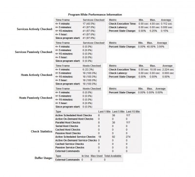

As for the problem, can you show us what your System/Performance Info looks like? See my attachment for an example.

Mine looks like:

Something is wonky with your checks - they're taking far too long. Do they take this long when run from the command line?
15.048 * 169 = 2543.112 seconds worth of service checks being processed every 60 seconds
10.054 * 75 = 754.05 seconds worth of host checks being processed every 60 seconds
55 minutes worth of checks being run every minute...
Next step is to verify that your checks are finishing in a timely fashion when run at the shell.

[nagios@twilight ~]$ time libexec/check_ping -H 10.30.30.18 -w 100.0,20% -c 500.0,60% -p 5
PING OK - Packet loss = 0%, RTA = 1.48 ms|rta=1.480000ms;100.000000;500.000000;0.000000 pl=0%;20;60;0
real 0m4.001s
user 0m0.002s
sys 0m0.005s
[nagios@twilight ~]$ time libexec/check_icmp -H 172.16.1.151 -w 100.0,20% -c 500.0,60%
OK - 172.16.1.151: rta 1.580ms, lost 0%|rta=1.580ms;100.000;500.000;0; pl=0%;20;60;; rtmax=1.959ms;;;; rtmin=1.331ms;;;;
real 0m0.012s
user 0m0.001s
sys 0m0.002s
[nagios@twilight ~]$ time libexec/check_icmp -H 192.168.104.49 -w 100.0,20% -c 500.0,60% -p 5
OK - 192.168.104.49: rta 1.522ms, lost 0%|rta=1.522ms;100.000;500.000;0; pl=0%;20;60;; rtmax=1.722ms;;;; rtmin=1.439ms;;;;
real 0m0.011s
user 0m0.001s
sys 0m0.002s
[nagios@twilight ~]$ time libexec/check_icmp_4k 192.168.104.49
ICMP 4K OK: 5
real 0m4.021s
user 0m0.004s
sys 0m0.013s
Just to make sure that I checked all of the services here is it's config:
define host {
use cisco8xx
host_name 9maya16
alias 9maya16
parents kosm65-gw2
address 10.30.30.18
use cisco8xx-local-service
host_name 9maya16
service_description icmp
check_command check_ping!100.0,20%!500.0,60%
host_name 9maya16
service_description tunnel
check_command check_icmp!172.16.1.151!100.0,20%!500.0,60%
host_name 9maya16
service_description LAN
check_command check_icmp!192.168.104.49!100.0,20%!500.0,60%
host_name 9maya16
service_description icmp 4k
check_command check_icmp_4k!192.168.104.49
