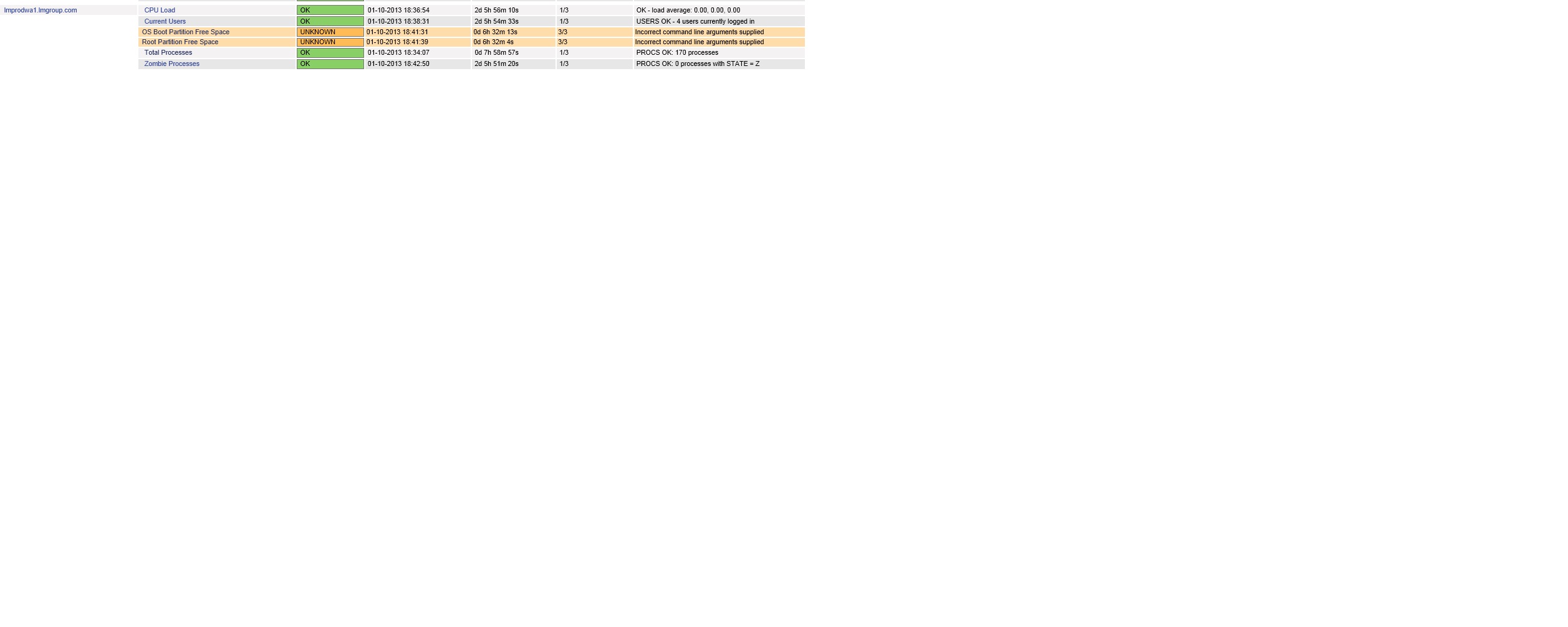

I have a number of linux server (RHEL 6.2) that I'm trying to monitor, predominantly using NRPE. Although there is a canned service definition to monitor the local /dev/hda1 drive, its not useful for my purposes, as I have sda drives and I'd much prefer to monitor mounted filesystems (due to using LVM). I did some research and tried to use the check_disk command, verified that the check_disk plugin in located in the /usr/local/nagios/libexec directory on both the Nagios server and the monitored linux server, and setup the following on the Nagios server:
a definition in commands.cfg:
# 'check_disk' command definition
command_name check_disk
command_line $USER1$/check_disk -H $HOSTADDRESS$ -w $ARG1$ -c $ARG2$ -p $ARG3$
and then setup a service definition in my linux.cfg file (service configs for all my linux servers):
host_name lmprodwa1.lmgroup.com
service_description Root Partition Free Space
check_command i/usr/local/nagios/libexec/check_disk -w 20% -c 10% -p /
and on the monitored linux server, I setup the following in my nrpe.cfg file:
command[check_disk]=/usr/local/nagios/libexec/check_disk -w $ARG1$ -c $ARG2$ -p $ARG3$
after I restart my Nagios service and refresh the console GUI, I keep getting the same Unknown status and the message "Incorrect command line arguments supplied" (see attached screen capture).
although the check_disk info states that you can either use the explicit path to the disk (eg. /dev/sda1), you can also use the mounted filesystem name (eg. /boot). the / partition that I'd like to monitor is actually /dev/mapper/vg_octemplate-lv logical volume. is that what the issue is? that check_disk can't monitor logical volumes? or is it a misconfiguration in one of my settings? any ideas?
thanks in advance,
Jeremy

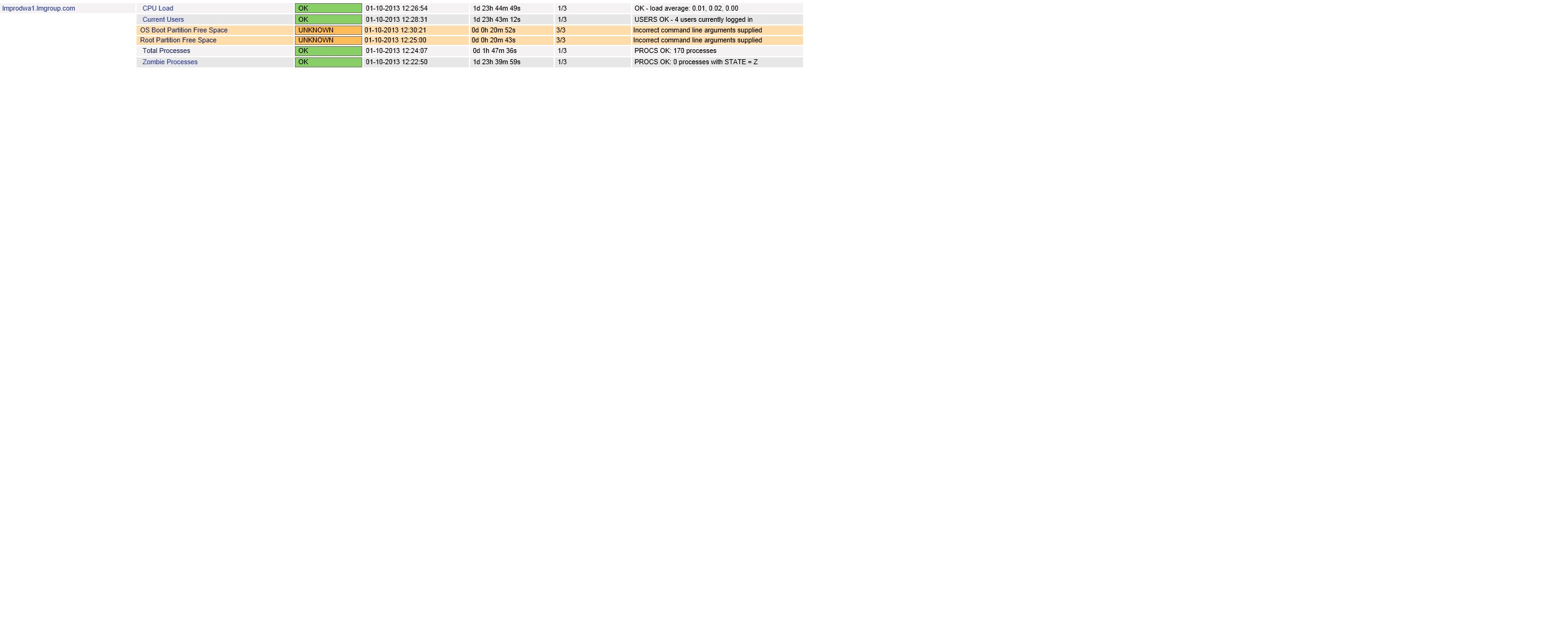

update: so I took the below information (or what I think I understood from it) and now when I attempt to run prelight before restaring my Nagios server, I get the following error:
Error: Service check command 'check_nrpe -c check_disk -w 20% -c 10% -p /' specified in service 'Root Partition Free Space' for host 'lmprodwa1.lmgroup.com' not defined anywhere!
I'm still doing something wrong... sigh!

abrist, you rock and thank you for all that concisely worded info... but it didn't work. I made every change exactly as you listed them, and although now I don't get any preflight errors when I test the config, I still get an "Incorrect command line arguments" error in the Nagios console display (Status Information column), as per the attached screen capture. Anything else that I can check/reconfigure?
