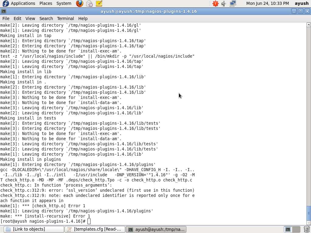

I downloaded the file and installed with the said instructions but it gave me errors and also after that I checked the libexec directory but found nothing. Attached are the 2 screenshots of the error i got. 1st is when i ran "make" and 2nd is when i ran "make install"
error when running the command "make install"
error when running the command "make"
Posts: 13589
Re: Return code of 127 is out of bounds - plugin may be miss
Run:
yum install libssl-dev -y
then try recompiling again.

logged in as root and ran the code:
[root@ayush ayush]# yum install libssl-dev -y
After that recompiled again but no luck. Still the same errors and empty libexec directory.
