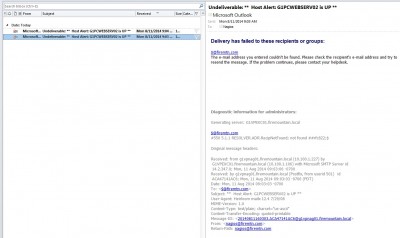

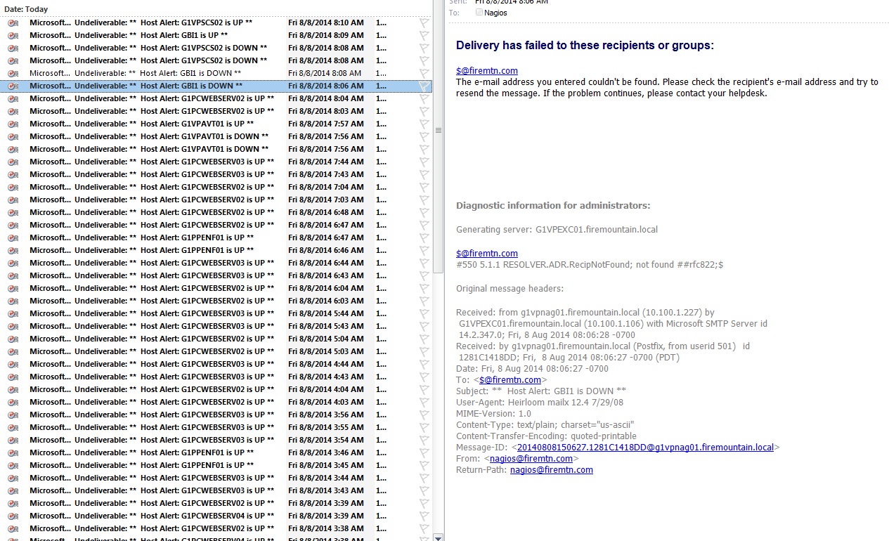

That part is a problem. My host and/or services are not going down that much......yet I get bogus emails constantly.
As you can see in the attached image, lots of messages nagios is sending, and it is sending them to a bogus email.
I have included the debug file that covers the same time frame as the screen shot.
for example, you can see in the screen shot, it attempted to email saying host GBI1 is down, then shortly afterward, it tried sending an email saying it was up. Yet, when looking at the debug file, it never says anythign about it being down.

The images is helpful but the debug log is for the time period 08:15:46 to 08:15:48, so I can't compare the two.
I'm guessing your timezone is GMT-7 (PDT or MST).
Can you post the debug log for the time period:
07:50:00 = [1407509400.xxxxxx]
to
08:10:00 = [1407510600.xxxxxx]
Then we can compare the screenshot to the debug log.

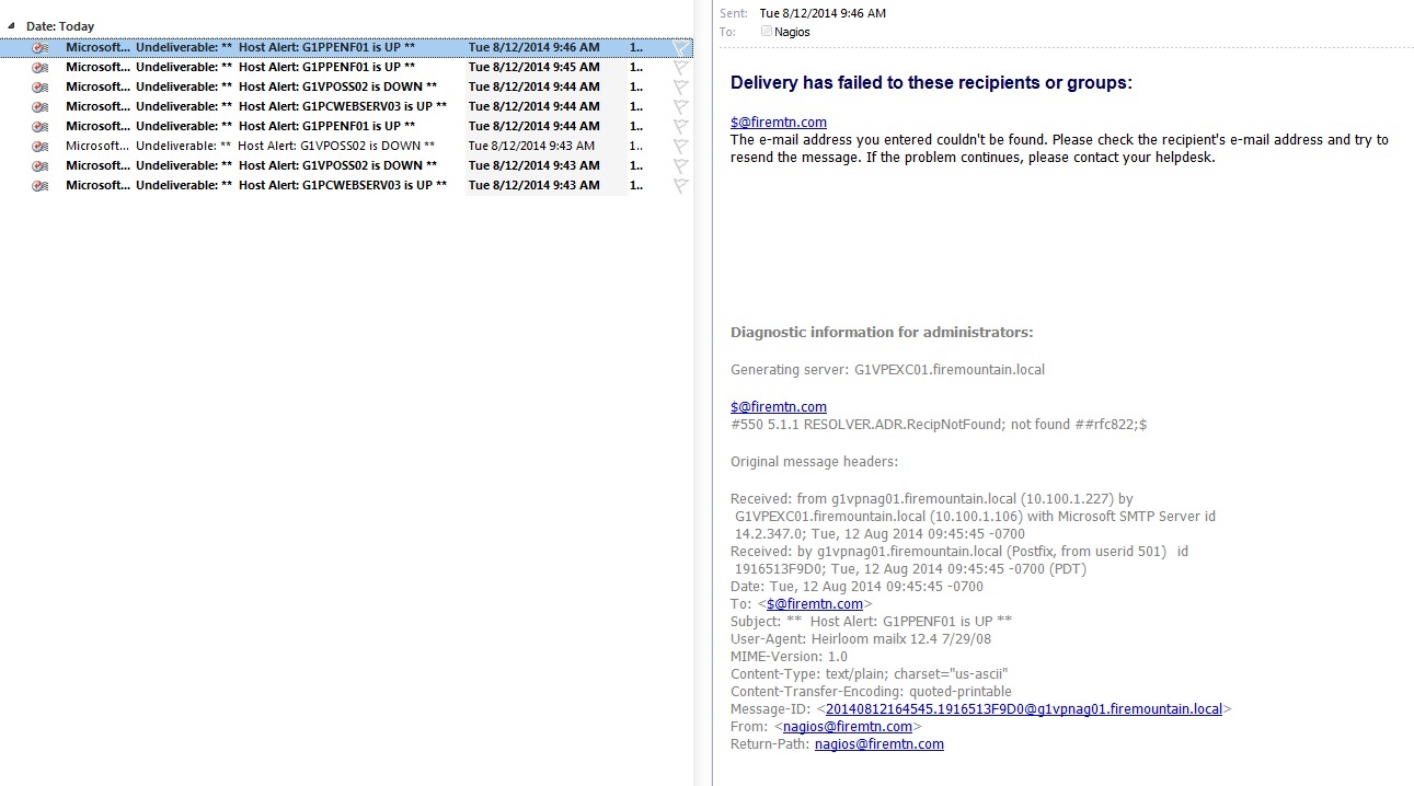

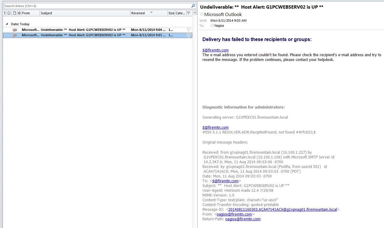

click on the image and you can see the full email.
Nagios doesn't have any idea if a message is undeliverable or not. it just sends emails about, it doesn't recieve any.
even if it was trying to resend......the one issue is that it is trying to an email address that is not set anywhere.
Im thinking that it (for some stupid reason) is that it sends these bogus emails everytime a service or host state changes, but becasue it hasn't researched the time it should really send an email, it puts a blank address in the "To:" box.
Alos, dont forget, on teh web interface, and I go to the Notification link, it does not show it sent anything, nor does the event log.

If you view the attachment, bogus emails had been sent.
