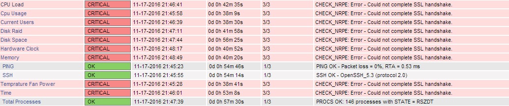

i get this error on my nagios client that want monitor that
[root@linux- libexec]# /usr/local/nagios/libexec/check_nrpe -H localhost
/usr/local/nagios/libexec/check_nrpe: error while loading shared libraries: libssl.so.4: cannot open shared object file: No such file or directory
and show ths eror on nagios monitor for that server attached pic
Hi

i use nagios core Version 4.1.1
my nrpe version is nrpe-2.15.tar.gz i use this nrpe on all of my linux servers but most of them are redhat 6.4 and just this is redhat 6.8 and my server can not connect to internet now how can solve problem?

check_nrpe needs to be recompiled on your system. I don't know how your system got into this state but you can confirm it by:

this is output
ldd /usr/local/nagios/libexec/check_nrpe
linux-gate.so.1 => (0x0026a000)
libssl.so.4 => not found
libcrypto.so.4 => not found
libnsl.so.1 => /lib/libnsl.so.1 (0x00d1b000)
libc.so.6 => /lib/libc.so.6 (0x0040c000)
/lib/ld-linux.so.2 (0x00fd5000)

I would suggest upgrading to NRPE 3. There are a lot of security improvements: https://www.nagios.com/news/2016/07/nrpe-3-release/. We're actually on 3.0.1 now, but the v3 page has more information.
Assuming that's not an option right now, run locate libssl.so.4 and then recompile NRPE with ./configure --with-ssl=/path/to/ssl. It sounds like you have the compressed files on the server, so that is likely the quickest, if not the best option.
