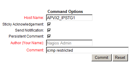

Attached are the screenshot for the steps i followed :
let me know if i need to add something in configuration file
