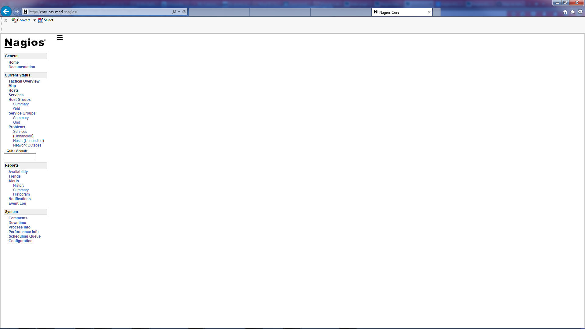

Hello all! This is my first post so I hope I've placed the topic in the correct forum.
My employer is implementing Nagios on an Ubuntu 14.04.2 LTS server (Trusty Tahr) and we are experiencing an issue with the status map. We have successfully installed the latest and greatest (Nagios 4.1.0rc1), but the status map will not load in Internet Explorer 11 on my Windows 7 Professional desktop. We had also experience an issue with the statusmap_icons not displaying in other browsers (Firefox 38.0.5, in particular), but this was fixed by downloading the latest development version (see https://github.com/NagiosEnterprises/na ... /issues/25 for reference). I have included a screenshot of the Nagios Status Map screen to show exactly what loads and what doesn't.
I have verified that the plugins are installed, permissions are correct, JS files are present, etc., and just don't know where to go from here. Has anyone run into this issue? Or are there any suggestions for troubleshooting this problem further? Thank you!

tgriep, I have done as you suggested (I clicked the "Reset" button in IE's Advanced settings, cleared temporary Internet files, history, passwords, etc., and disabled all add-ons), but the result is the same. I had not tried this before (my bad!), but I have attempted to add the URL to Trusted Sites and lower the security on that zone to Low. I have also tried adding the site to my Compatibility View Settings, again to no avail.
I didn't mention previously that the server is running Apache 2.4.7--don't know if that's important. Please let me know if more software version/information is important. Thank you!

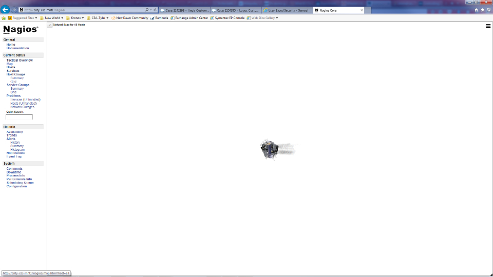

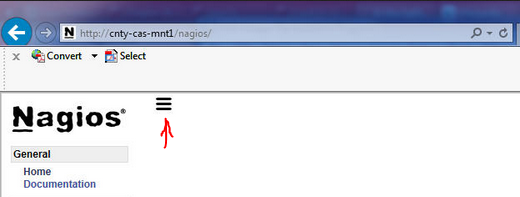

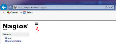

Re: Nagios 4.1.0rc1 Status Map does not display in IE 11
Can you click on the icon? See below:
Any errors in the apache error log?
No, clicking the icon does nothing.

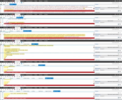

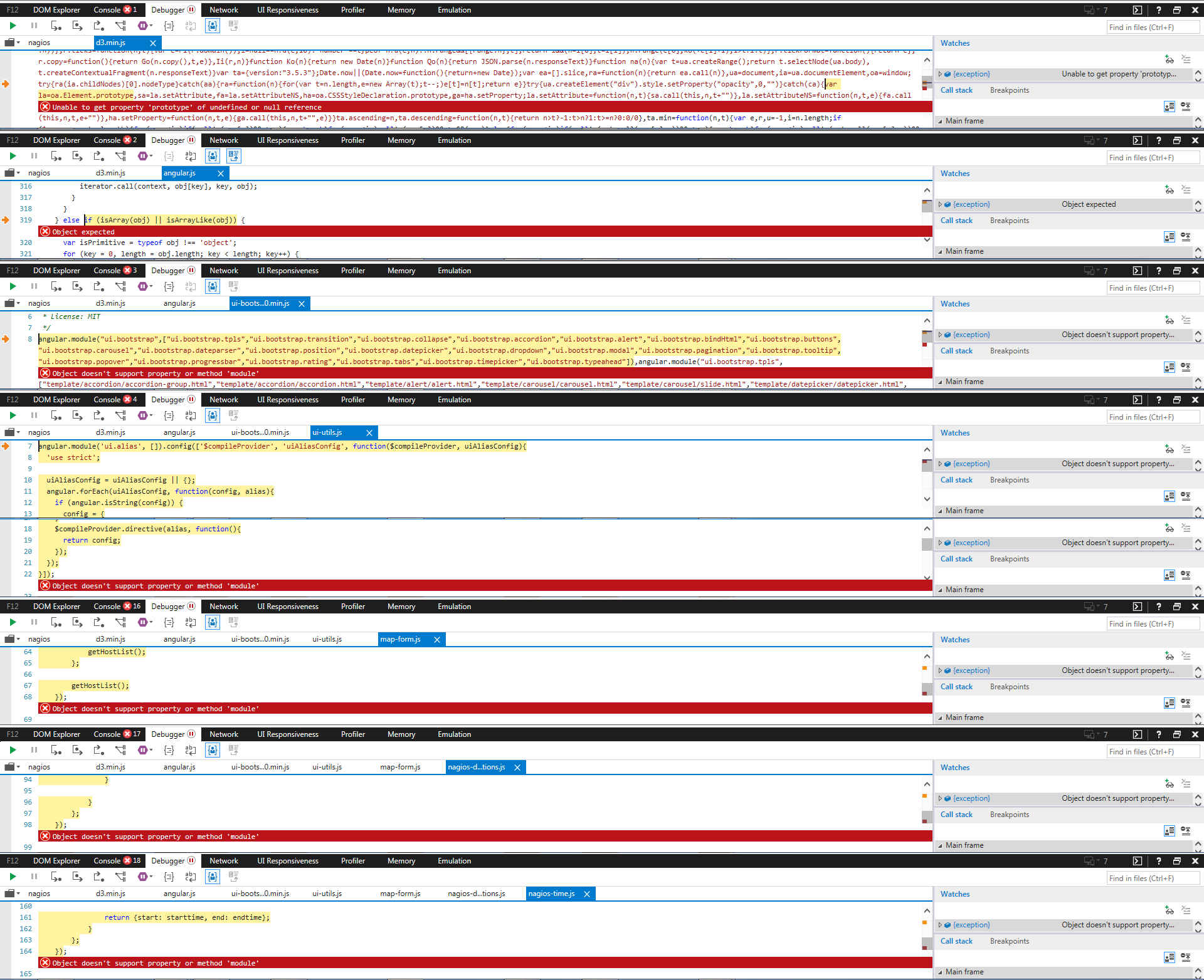

If you open up the Internet Explorer developer console (F12), is there any suspicious output in either the 'Debug' or 'Network' tabs?
jolson, I think you're on the right track! (Sorry, I'm not a frequent user of IE and didn't know of the Developer Tools.)
There appear to be 3 main JavaScript errors on the page:
1) 'd3.min.js' line 3: var `la` is assigned the value of `oa.Element.prototype`, but the `prototype` property is undefined ("Error: Unable to get property 'prototype' of undefined or null reference)
2) 'angular.js' line 319: checks whether the object `obj` is an array, but `obj` is not an instantiated object (Error: "Object expected")
3) subsequent JS files: calls to the `angular.module` property fail (Error: "Object doesn't support property or method 'module'")
I assume that #3 is a result of #2 failing, but am currently unsure why the first two JS errors occur. I will be investigating this (now that I know of the Developer Tools), but would still appreciate the expertise of you fine folks! Thank you very much!

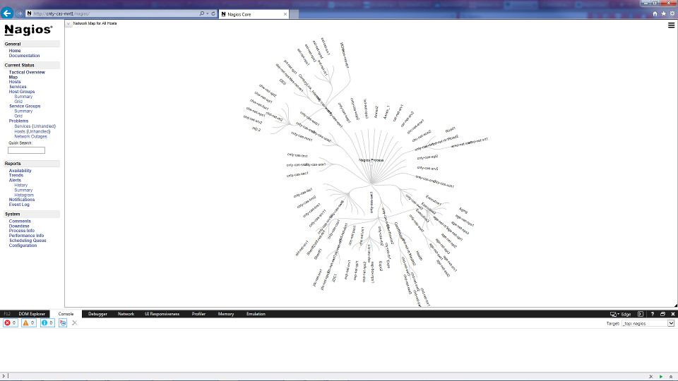

Okay, so this is not any kind of problem with the the JavaScript. Apparently, IE puts all websites from the intranet zone into compatibility mode by default (WTF?). The document mode in compatibility view is IE7, at which point the `Element.prototype` had not yet been implemented. To fix this, I had to go into IE's Compatibility View settings and uncheck the box to "Display intranet sites in Compatibility View".

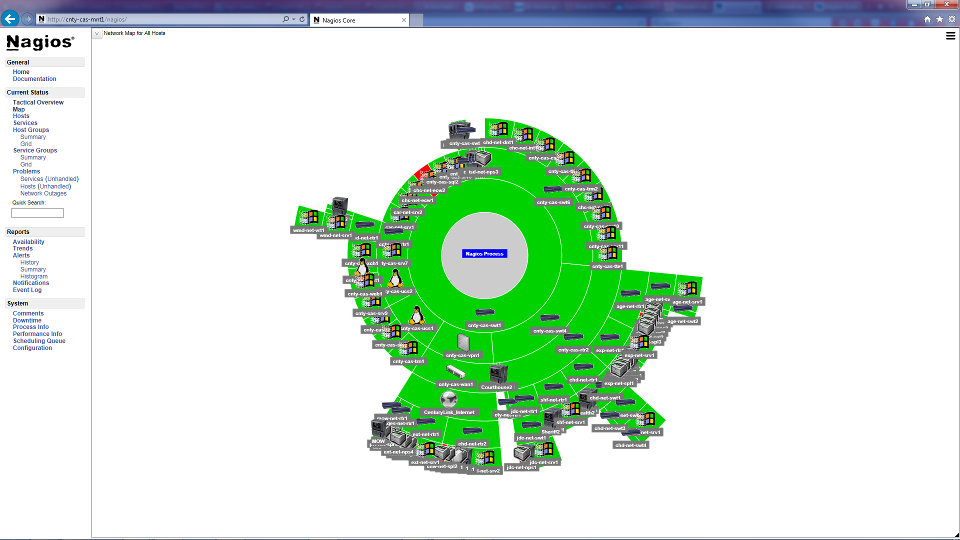

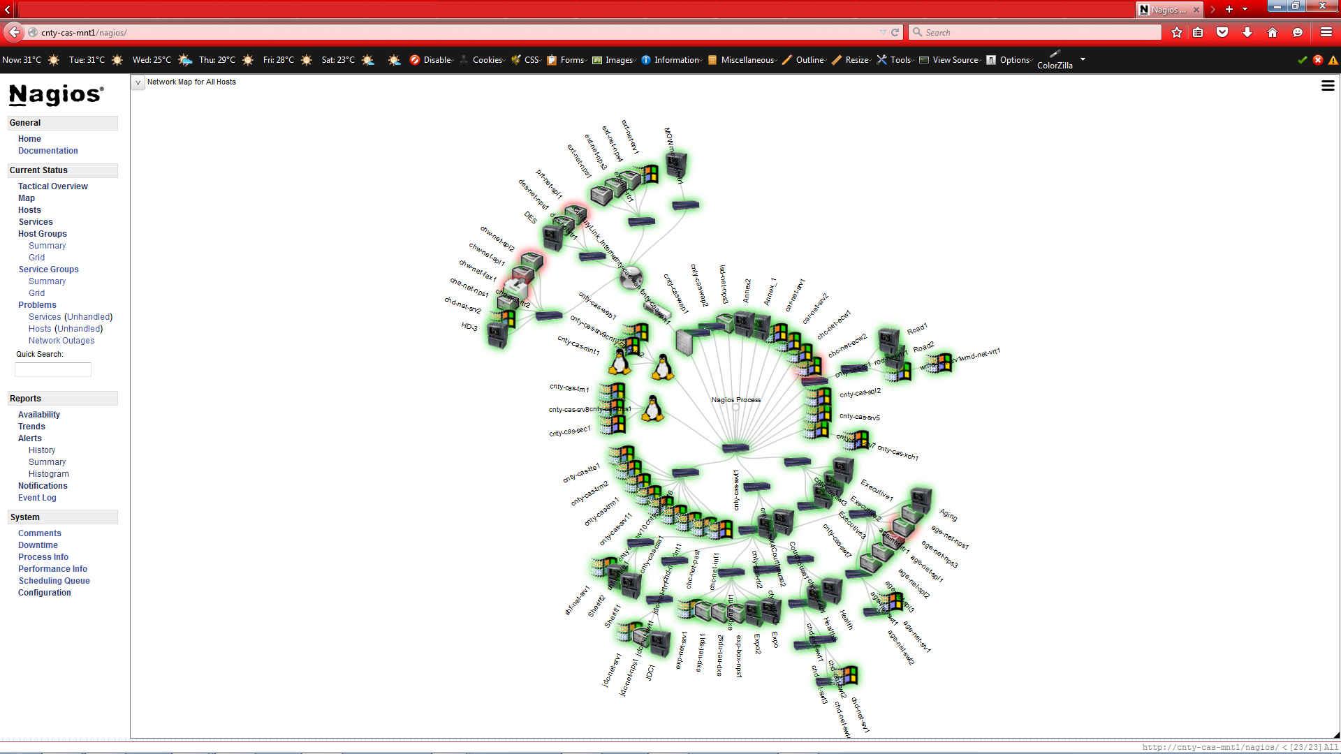

Okay, so now the status map displays... but it has no icons. As I stated in my first post, the icons didn't display in any browser until I downloaded the latest development release; however, I didn't mention that the statusmap_icon directive still didn't work. Instead, the status map seems to use the icon_image directive. I don't know if this is intentional behavior or not. I only had the icon_image directives in the config files, but since there were no icons displaying in IE (and only IE... eugh), I also added the statusmap_icon directive. I am still unable to see any icons on the status map. Furthermore, I don't see any of the red/green dots on the map which indicate the host's online/offline status. I again reset my browser, cleared temporary Internet files, cookies, etc., and unchecked the Compatibility View for intranet sites... but still no luck. IE's Developer Tools has no helpful output either.
Here's the kicker: the images are loaded successfully and display for a brief second as the map expands from a single point into the full web (using the Circular Balloon display). So I tried to change the map display, and none of them display icons or dots... except for the Circular Markup! ... I'm confused. Any suggestions? Thank you again for all of your helpful comments!
