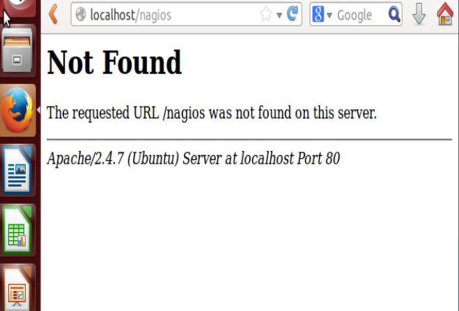

Well, I have a vm of ubuntu 14.04LTS and Apache works correctly. But trying to access http://localhost/nagios doesn`t work.
the error is:
Not Found
the requested URL /nagios was not found on this server.
Apache/2.4.7 (Ubuntu) Server at localhost Port 80
I think maybe the problem is that nagios has installed in a wrong path, and in that case apache can`t find it.
Can someone explain me how to solve this problem? Is the documentation of the link correct?

Here's a guide I did a while ago:
http://sites.box293.com/nagios/guides/i ... untu-14-04
I believe the key to your problem lies with the configure command, it needs to be pointed to the /etc/apache2/sites-enabled location:
./configure --with-nagios-group=nagios --with-command-group=nagcmd --with-mail=/usr/bin/sendmail --with-httpd-conf=/etc/apache2/sites-enabled

Thank you so much@Box293,
The problem was that I forgot put these commands:
Type iptables -I INPUT -p tcp --destination-port 80 -j ACCEPT and press Enter
Type apt-get install -y iptables-persistent and press Enter
Press Enter on Yes to save current IPv4 rules
Type a2enmod rewrite and press Enter
Type a2enmod cgi and press Enter
Type service apache2 restart and press Enter
Congrats for your link.

Yes, now its working. :)
