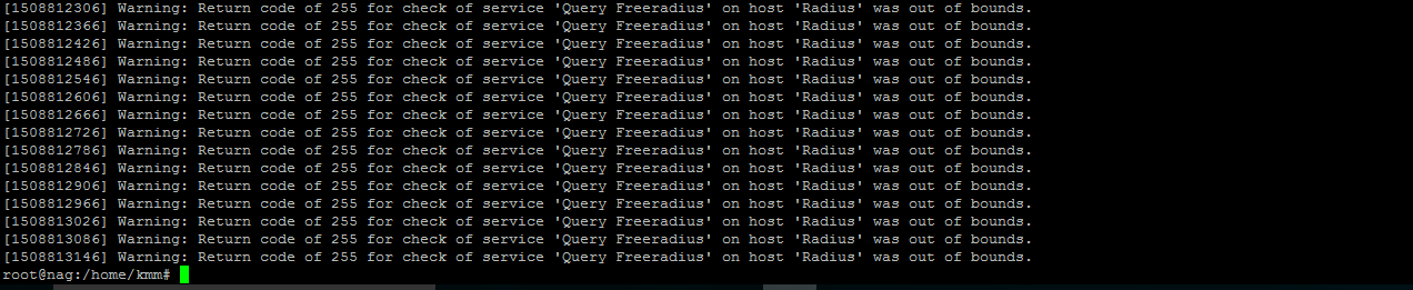

Please help me with this, I want to monitor the freeradius server in nagios server. But the error is Could not interrogate RADIUS server status. How can I solve that.

This is my nagios server state information.

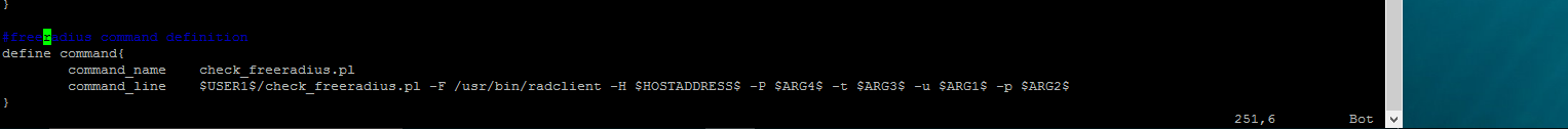

Can you show us how you defined the check_command for this service that uses check_radius.
I want to see how you have this host/service set up and it's command.
cat /usr/local/nagios/etc/objects/commands.cfg
cat /usr/local/nagios/etc/objects/Radius.cfg

Let me say, for integorate error, I change some config. So now, the error termed to "no output returned from plunins" . All screen shot I sent are for current error (no output). Thank you so much for your advises.

When I create radius.cfg under /usr/local/nagios/etc/objects/, happends config duplicate. that's why I remove it. still left in commands.cfg. Please, kindly help . I really appreciate all of your advices.
Khin
This is cat /usr/local/nagios/etc/objects/commands.cfg file.

Thanks for showing us the command definition. What version of Freeradius are you using? I would like to replicate this.
Are you running this plugin only through the terminal?
Yes, i wouldn't create another radius.cfg, but if you could show me the contents that inside of your existing radius.cfg that would help.
I want to see how you are passing the $ARG$ when using the plugin.
