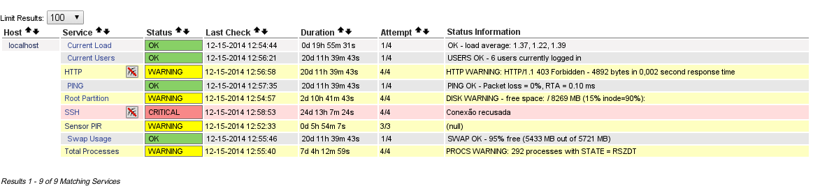

Good afternoon, I developed a plugin in Python to read a value of a presence sensor connected through the serial port with arduino. I used several techniques, the latest version used the pynagios library. I realized that by removing the code that connects the serial port the plugin works normally, but to keep the code snippet in webinterface and returns status WARNING and status NULL. Someone can help me ? Please

I think not, because I run manually and works normally. In this example that I said the passage that communicates with the serial port and I configured the manual value

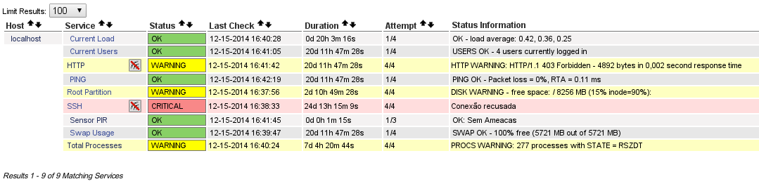

Working, but i set this values manually
See, I commented the code that instantiates the serial port
cli:
[root@tux-mateus plugins]# python tcc2.py
OK: Sem Ameacas

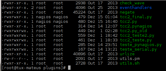

Re: Plugin return report NULL
What are the permissions on the plugin? It seems like it might not have permissions as the nagios user to open the serial pipe.
Can you try to "su nagios" and run it as the nagios user? Then run "echo $?" to see the exit code. I'll be it is 1.

Post by filipe.avelino1 »
My permissions
I could not use the su command nagios returns the account is not available at the time. I execute echo $? , return 1

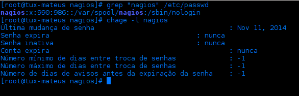

You might not have the nagios user, but that should show other problems as well. Try running the following:
grep "nagios" /etc/passwd
chage -l nagios
filipe.avelino1
Posts: 6
Joined: Mon Dec 15, 2014 12:31 pm
Return:
