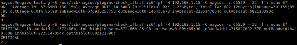

Hello, I am having a extrange problem with a perl plugin:
check_iftraffic64.pl https://exchange.nagios.org/directory/Plugins/Network-Connections%2C-Stats-and-Bandwidth/check_iftraffic64/details
This plugin checks the traffic using SNMP, and do the job fine but I have a problem when shows the results in the WEB-GUI which I could not resolv.
As it can see in the image, the result is "OK" but the status is "UNKNOWN". I got in touch with the developer but he could not figure out what the problem was. I kept doing some researches and debugging but I do not know what to do, so I ask for your help. I got the same result in three Nagios installations (one of them a clean one).
Debug info:
[1483644257.422936] [016.1] [pid=21070] Embedded Perl ran /usr/lib/nagios/plugins/check_iftraffic64.pl: return code=3, plugin output=OK - Average IN: 9.71KB (0.01%), Average OUT: 11.76KB (0.01%)Total RX: 1.06GBytes, Total TX: 417.88MBytes
|inUsage=0.01%;85;98 outUsage=0.01%;85;98 inBandwidth=9712.38B
|outBandwidth=11759.16B inAbsolut=1056798111c outAbsolut=417877276c\n
return code=3
If I run the plugin from terminal and I do "echo $?" it returns code 0
I also created a perl file with:
#!/usr/bin/perl -w
exit $STATUS_CODE{'OK'};
And it shows OK as result.

Postby dwhitfield » Mon Jan 09, 2017 12:26 pm
What's the output of sestatus?
Did this ever work? If so, your apt log might be useful. Also, if it did work before, when did it stop working?
Is there a reason you are still running 3.5.1? Compiling from source only takes about 5 minutes. Instructions at https://support.nagios.com/kb/article.php?id=96. Do not compile from source over the top of the repo install. You'll have to uninstall if you choose to upgrade.

Postby avandemore » Mon Jan 09, 2017 1:38 pm
When you run the plugin from the command line it should be like this:
# su - nagios
$ /path/to/plugin $ARGs
Immediately after the plugin returns run:
$ echo $?
Or even more concisely:
# su - nagios
$ /path/to/plugin $ARGs; echo $?

Re: Bad result code in a PERL plugin
Postby andresrinaldi_uy » Mon Jan 09, 2017 1:46 pm
I have done this while I was testing and all seems to work fine, but in the WEB-GUI still orange it does not matter if OK or CRITICAL, the return code is always 3

Postby dwhitfield » Mon Jan 09, 2017 4:32 pm
Perhaps there is a permission error. What's the output of ls -la /usr/lib/nagios/plugins?

Postby andresrinaldi_uy » Mon Jan 09, 2017 8:09 pm
I've already checked it, the same permissions that other plugins.

Postby rkennedy » Tue Jan 10, 2017 9:50 am
The original definition you have varies from the check command you posted above. The screenshot mentions -i 65539 where as your service definition is for 11. You'll want to match these up in order to see the same result across the board.
