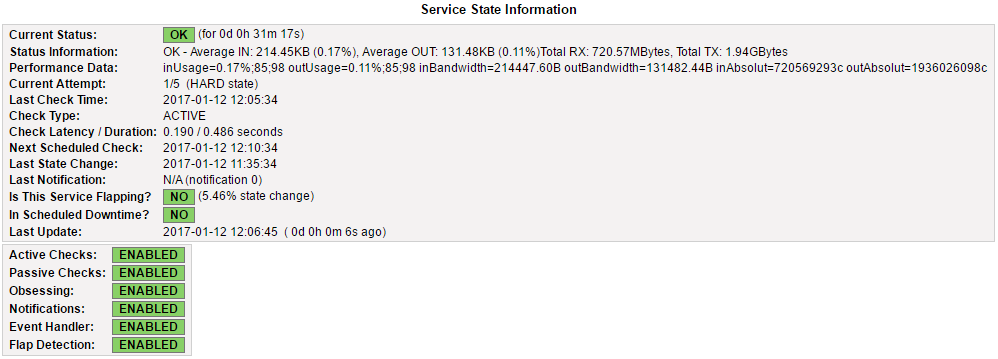

Postby andresrinaldi_uy » Thu Jan 12, 2017 10:10 am
I did this but the result was worst. With this in mind I did some research and I found this article:
https://assets.nagios.com/downloads/nagioscore/docs/nagioscore/3/en/embeddedperl.html
Change this setting from 1 to 0 for testing purpose
use_embedded_perl_implicitly=0
And it worked, but CPU consumption was too high so I kept reading and found something interesting:
Plugin-Specific Use of the Perl Interpreter
Beginning with Nagios 3, you can specify which Perl plugins or scripts should or should not be run under the embedded Perl interpreter. This is particularly useful if you have troublesome Perl scripts which do not work well with the Perl interpreter.
To explicitly tell Nagios whether or not to use the embedded Perl interpreter for a particular perl script, add one of the following entries to your Perl script/plugin...
To tell Nagios to use the Perl interpreter for a particular script, add this line to the Perl script:
# nagios: +epn
To tell Nagios to NOT use the embedded Perl interpreter for a particular script, add this line to the Perl script:
# nagios: -epn
Either line must be located within the first 10 lines of a script for Nagios to detect it.
So I added "# nagios: -epn" to the plugin and this solved the problem.
In conclusion, this plugin works as should without the Nagios embedded perl.
Thanks a lot for all your help.
