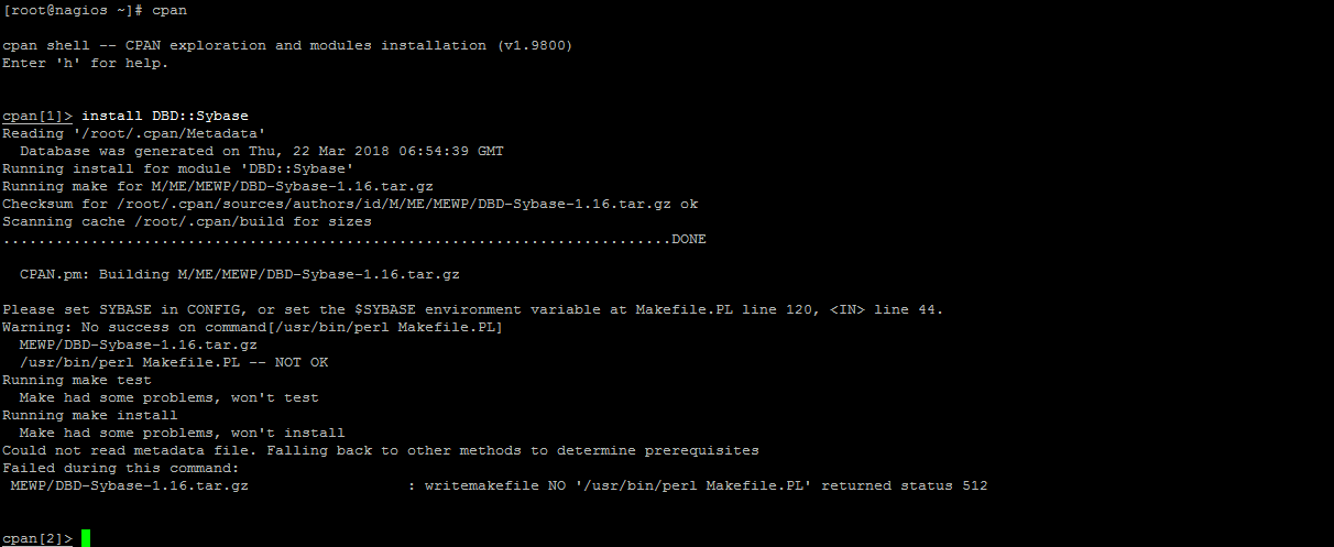

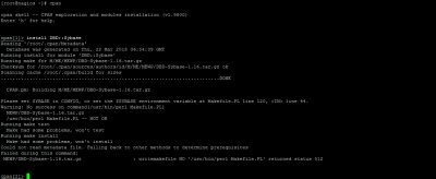

Hi , I have tried to install running the above command but getting below error :npolovenko wrote:@sshekhar, Have you installed the DBD::Sybase module?
From your command line please run:Code: Select all
cpan install DBD::Sybase
"Please set SYBASE in CONFIG, or set the $SYBASE environment variable at Makefile.PL line 120, <IN> line 44.
Warning: No success on command[/usr/bin/perl Makefile.PL]
MEWP/DBD-Sybase-1.16.tar.gz
/usr/bin/perl Makefile.PL -- NOT OK
Running make test
Make had some problems, won't test
Running make install
Make had some problems, won't install
Could not read metadata file. Falling back to other methods to determine prerequisites
Failed during this command:
MEWP/DBD-Sybase-1.16.tar.gz : writemakefile NO '/usr/bin/perl Makefile.PL' returned status 512"

install DBD::SybaseHere's what I have on the line 44 in Makefile.PL :"Please set SYBASE in CONFIG, or set the $SYBASE environment variable at Makefile.PL line 120, <IN> line 44.
$ldflags = "-L$SYBASE/$libdir $ldflags" unless $^O eq 'VMS';As of May 25th, 2018, all communications with Nagios Enterprises and its employees are covered under our new Privacy Policy.

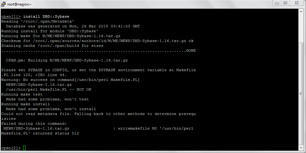

Hi, i have tried installing DBD but still no luck, still i am getting the same error :
Also freetds-devel is installed.
cpan[2]> exit
Lockfile removed.
[root@nagios ~]# yum install freetds-devel
Loaded plugins: fastestmirror, langpacks
base | 3.6 kB 00:00:00
epel/x86_64/metalink | 8.3 kB 00:00:00
extras | 3.4 kB 00:00:00
packages-microsoft-com-prod | 2.9 kB 00:00:00
updates | 3.4 kB 00:00:00
Loading mirror speeds from cached hostfile
* base: mirror.vbctv.in
* epel: mirror.xeonbd.com
* extras: mirror.vbctv.in
* updates: mirror.vbctv.in
Package freetds-devel-0.95.81-1.el7.x86_64 already installed and latest version
Nothing to do
[root@nagios ~]#
