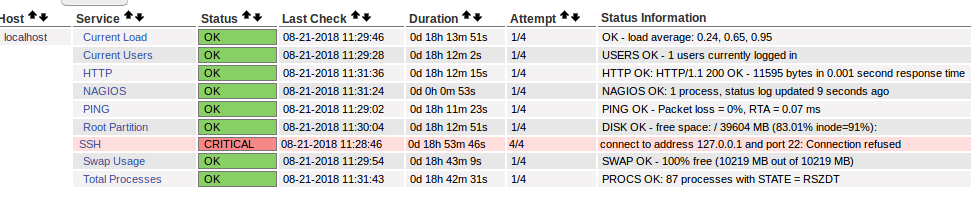

-> I need some support, check_nagios plugin i configure the service detail in /usr/local/nagios/etc/objects/ localhost.cfg file and passing parameter same path i added in commands.cfg file . After adding the plugin service i am able to see the ui page for the check_nagios plugins , But Status Information ui fetching /usr/local/rtm/var under status.dat file how to modify the dat file, nagios ok status information .
-> check_nagios plugin name i configured as NAGIOS that is showing in ui page service NAGIOS : and Status Information name changes : NAGIOS OK : 1 process, status log updated 8 seconds ago
-> Below i pasted the Status Information NAGIOS OK name changes snap , Give me a suggestion for modify this Nagios Ok in ui page . I am waitting for replies.

Postby scottwilkerson » Tue Aug 21, 2018 7:46 am
I am really unclear about your question but here is the help for the plugin
/usr/local/nagios/libexec/check_nagios -h
check_nagios v2.2.1 (nagios-plugins 2.2.1)
Copyright (c) 1999-2014 Nagios Plugin Development Team
        <devel@nagios-plugins.org>
This plugin checks the status of the Nagios process on the local machine
The plugin will check to make sure the Nagios status log is no older than
the number of minutes specified by the expires option.

Postby jagannathan » Tue Aug 21, 2018 11:42 pm
Hello scottwilkerson ,
-> /usr/local/nagios/libexec/check_nagios -h , yes this details are plugin help and parameter adding details , After add the plugin for configuration localhost.cfg ,command.cfg file and staus.dat file fetching the information for particular add the plugin detail and visible in ui that snap below i pasted Verify and give me a suggestion for changing status dat file .
-> download/file.php?id=23323&mode=view .
-> if i made any modification in localhost.cfg after nagios restart ,then /usr/local/nagios/var status.dat file fetching the modification information and visible in ui page ,is it possible to modify the dat file .

Postby scottwilkerson » Wed Aug 22, 2018 7:02 am
After making changes to the localhost.cfg you need to restart nagios and it will update the status.dat file
Posts: 15365

Postby jagannathan » Mon Aug 27, 2018 12:38 am
Hello scottwilkerson,
-> Everytime i made changes with the configuration file, it will update the status.dat file automatically is it correct
-> Is it possible to change the status.dat file manually .
jagannathan
Posts: 26
Joined: Sat Jun 16, 2018 7:21 am
Re: Regarding plugin name changes
Postby scottwilkerson » Mon Aug 27, 2018 7:58 am
jagannathan wrote:-> Everytime i made changes with the configuration file, it will update the status.dat file automatically is it correct
Only after you restart the nagios service
jagannathan wrote:-> Is it possible to change the status.dat file manually .
no
