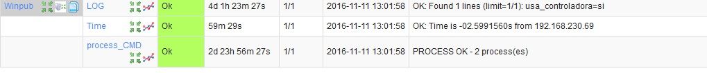

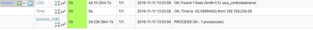

Re: Check_winprocess.exe
Without a cmd process running it show me ok 1 process
When i have 1 cmd process running in nagios show me 2 ok.
So, never show me critical...
I tested that command using notepad.exe and it worked.
What I am guessing is that when the plugin is ran, is spawns a command prompt to run it and that is why you always see 1 process.
Try changing the critical threshold to 1 and you should get the outcome you are looking for.
