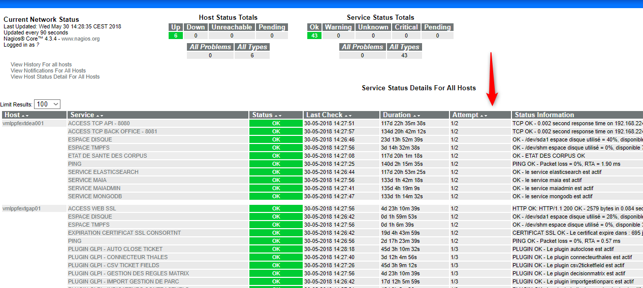

Hello, I have a question I want to add a column in the interface of the service tab to put the link to recovery procedures in case of service outage

The easiest way to do this is via the notes for a particular host/service:
Which produces the following:
Most other paths, including your specific situation where you want to add an entire column, require some knowledge of Nagios Core on the back-end as well as familiarity with old-school CGIs. Here's an older post I made in which I add a Kibana/Marvel link to a specific host on the status overview which references a custom macro included in my host definition:

notes Here are some simple steps to fix problems.
notes_url http://www.example.com

To add a column to the Nagios Core interface you would need to make your change in the source code and then re-compile

Many people put it in the notes field, or Notes URL and get there from the detail page

Nagios Core doesn't have builtin language support, but again you could change it in the source and re-compile
