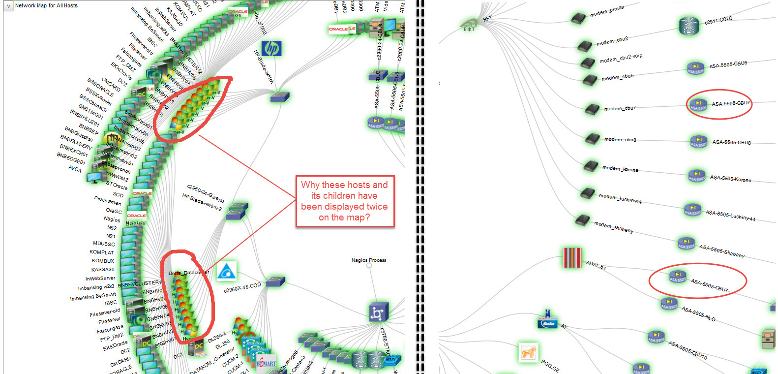

Can you tell me how to configure nagios properly for virtual hosting? I have mrtg page on the nagios server.
The Second question is why all hosts that have two parents have been displayed on the map twice (see examples in attach)?

whitest wrote:The Second question is why all hosts that have two parents have been displayed on the map twice (see examples in attach)?
That's a known problem. The D3 library used for the new maps doesn't handle multiple parents well at all. https://github.com/NagiosEnterprises/na ... /issues/34

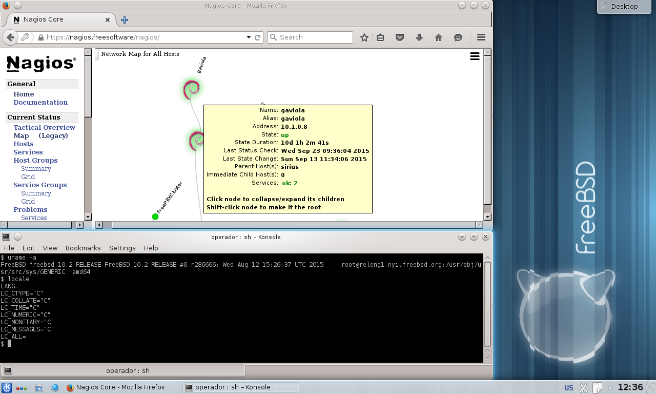

I made an interesting test in FreeBSD 10.2 virtual machine with Iceweasel 40.0.3. Here everything ran smoothly using the same Nagios server.

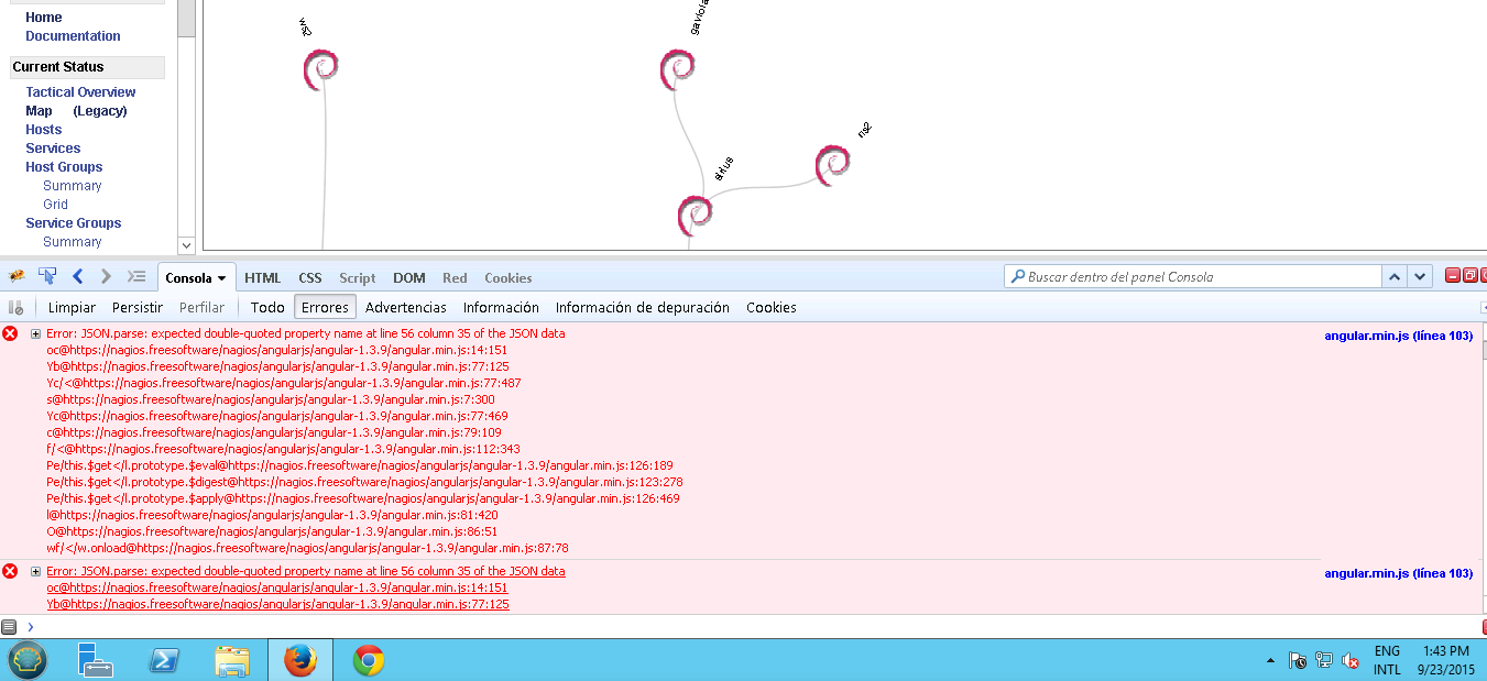

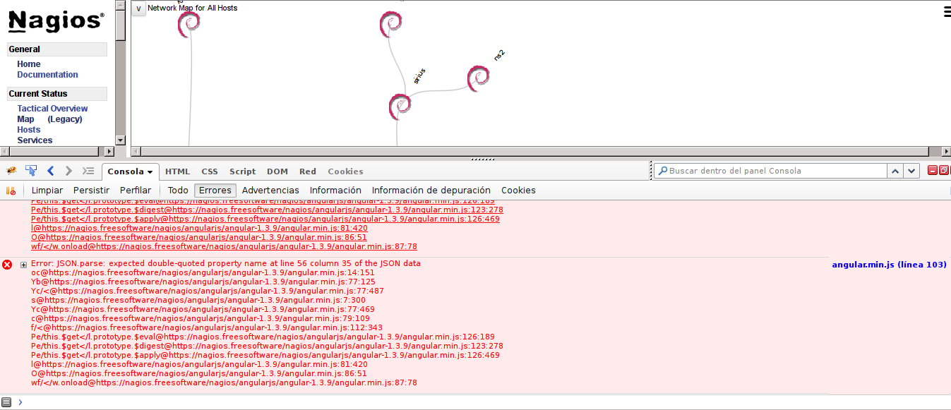

An interesting difference I've noticed when comparing the errors tab on the "Console" of Firebug for Iceweasel in Debian is it shows several errores when zoom the map or move the mouse pointer over the icons of the network map. On Firefox running on FreeBSD it doesn't happens when doing the same actions. Do you think this might have to do with the problem we're having in Debian? Attached screenshot.

Very interesting! I'll PM one of the devs and let him know there is more information. I was unable to reproduce the issue on Debian Jessie, but that was using the English one. Terrible things happened when I tried to install it in Spanish, as I speak about zero... I haven't had a ton of time to tinker around with this this week, we have our Nagios World Conference and a huge product update coming up this week and the next.

Thanks for sharing this information with the developers. Along the same line, I have installed Firebug on the Windows Server 2012 where I also have this problem with the information shown on the network map and I can see the same errors shown on Debian Jessie. Attached screenshot.
So we probably have something here. Especially if you do not see these errors in the tests where the information was displayed correctly. Can you confirm this?
