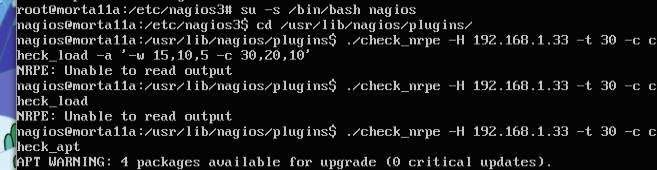

abrist
Red Shirt
Posts: 8334
Re: NRPE issue
Post by abrist »
Try the following as root (you may not have a shell set for nagios in /etc/passwd):
su -s /bin/bash nagios
If that does not work, post the output of:
cat /etc/passwd | grep nagios
jiggityjog
Posts: 20
Joined: Mon Apr 22, 2013 5:14 pm
Re: NRPE issue
Post by jiggityjog »
That worked abrist (! thanks!) and here are the results:
abrist
Red Shirt
Posts: 8334
Re: NRPE issue
Post by abrist »
Looks like some checks are working while others are not. Could you post (*in code wraps*) your remote nrpe.cfg and your nagios server's commands.cfg?
