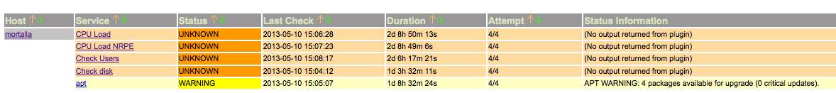

Sure thing. However, I did some sleuthing and found this blog. http://crashatau.blogspot.ca/2007/04/nr ... utput.html
So i check my /var/log/auth file and found lots of these:
May  9 14:31:21 mortalla sudo:   nagios : 3 incorrect password attempts ; TTY=unknown ; PWD=/ ; USER=root ; COMMAND=/usr/lib/nagios/plugins/check_load -w 1,2,3 -c 2,3,4
May  9 14:31:21 mortalla sudo: unable to execute /usr/sbin/sendmail: No such file or directory
May  9 14:32:07 mortalla sudo:    jason : TTY=tty1 ; PWD=/home/jason ; USER=root ; COMMAND=/usr/bin/pico /etc/nagios/nrpe.cf
The permissions for the plugin directory on the remote server are rwxr-xr-x, owned by nagios:www-data.
Anyway, here are the files you requested.
*NOTE: I've fairly recently added the sudo to the check_load, but that command is basically duplicated and redundant for testing purposes. I've fiddled with it below too, in the services file.

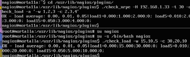

Lets drill down the check_load problem:
The command check_load does not require root access, so you can safely remove the "/usr/bin/sudo" before the command in the nrpe.conf:
command[check_load]=/usr/lib/nagios/plugins/check_load $ARG1$
From the remote host, try running:
 su root
su nagios
/usr/lib/nagios/plugins/check_load -w 15,10,5 -c 30,20,10
If that works, then we need to test it from the nagios server side. On the nagios server, try:
/usr/local/nagios/libexec/check_nrpe -H <remote host ip> -c check_load -w 15,10,5 -c 30,20,10
Let me know if either of these work/fail/etc.
Posts: 13587
Re: NRPE issue
Change this command definition in the nrpe.cfg file from:
command[check_load]=/usr/bin/sudo /usr/lib/nagios/plugins/check_load $ARG1$
to:
Restart the daemon, and try your check again. Is it still failing?

Hey guys. So I took the sudo out of the nrpe file and reloaded the service. This picture may be a little confusing. Morta11a (the top one) is my monitoring host. Mortalla, the remote. (Still no output from plugin on the web interface side)
EDIT: I noticed I didn't type exactly the command you specified for the monitoring server abrist (admittedly I lazily used a previous command that looked similar). Though when I tried it your way, I got
./check_nrpe: invalid option -- 'w'
Posts: 13587
Re: NRPE issue
It seems it's working now.

Yeah it does work (it actually took awhile for that to sink in!), but I'm still not getting anything on the web GUI. The only time I ever did was when I used check_nrpe_1arg.

Yah definitely reloaded the configuration and rebooted everything; that -c actually kept slipping my mind but I took it out. It shouldn't have mattered since check_load_nrpe was basically a duplicate command. But I'm pretty stumped. I've systematically gone through and amended all (maybe) the permissions, which I think is what opened up NRPE just recently to the monitoring host (or maybe it was editing that sudoers file). I can't see how a firewall would stand between the web interface and the data... Thanks again for the help!
