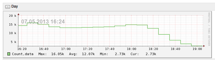

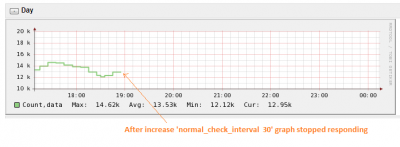

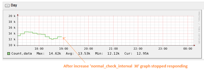

Postby pankajsain » Tue May 07, 2013 1:35 pm
Thanks for your reply,
Please find the screen-shots of the same.
with default interval
with normal_check_interval 30

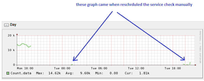

PS: One more thing i want to tell, whenever i reschedule the check manually, some data comes into the graph, please see below the screen-shot of it.
manual reschedule

Postby abrist » Tue May 07, 2013 1:50 pm
Upon creation, rrds are specified with a minimum necessary amount of actual data over a specified time frame. If the percentage of actual returned data is beneath the percentage threshold over the specified time, rrdtool considers this block of data as "bad". There is not a good solution to this problem as of yet, as any changes to the rrd creation template will be global.
