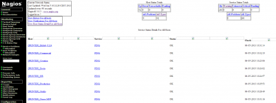

Hi Guys,
I've been running Nagios 3.0.3 for years on a FreeBSD 6.2 machine without any issues.
Yesterday I (had to) upgrade the BSD box to 9.1 and also apache to 2.2 (coming from 2.0).
I got everything to work again but Nagios webUI is being difficult as in the layout is really messed up.
See attachment.
Anyone who can help me fix this?
Much appreciated!
Antony

I upgraded Nagios to the latest versions in ports (3.5.0), hoping this would fix the lay out issue; but no luck.
Here`s the output of the apache error log:
[Wed Jun 05 21:14:13 2013] [error] [client xxx.xxx.xxx.xxx] File does not exist: /usr/local/www/nagios/nagios, referer: http://xxx.xxx.xxx/nagios/cgi-bin/status.cgi?host=all

Hm, so it seems like its looking for its file in a wrong directory as its looking in /usr/local/www/nagios/nagios (the extra nagios entry shouldnt be there)
I changed the doc root in the apache config from /usr/local/www/nagios to /usr/local/www and now the services/hosts pages work fine!
But the homepage does not work anymore because it wants to read main.php in /usr/local/www
hmm...
here`s my vhost config. Any ideas?
