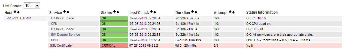

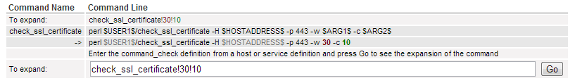

However, once I have added the command into Nagios I just check (null) returned:
Command
Command
Service
Service
Anyone using this script that could point me in the right direction?
