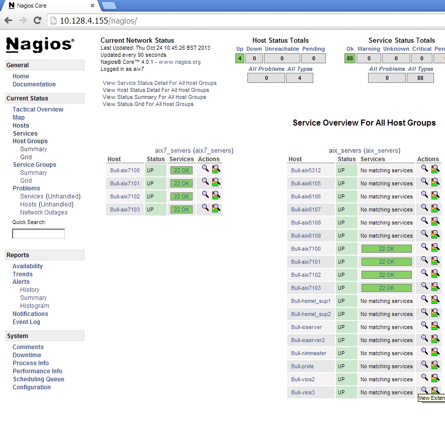

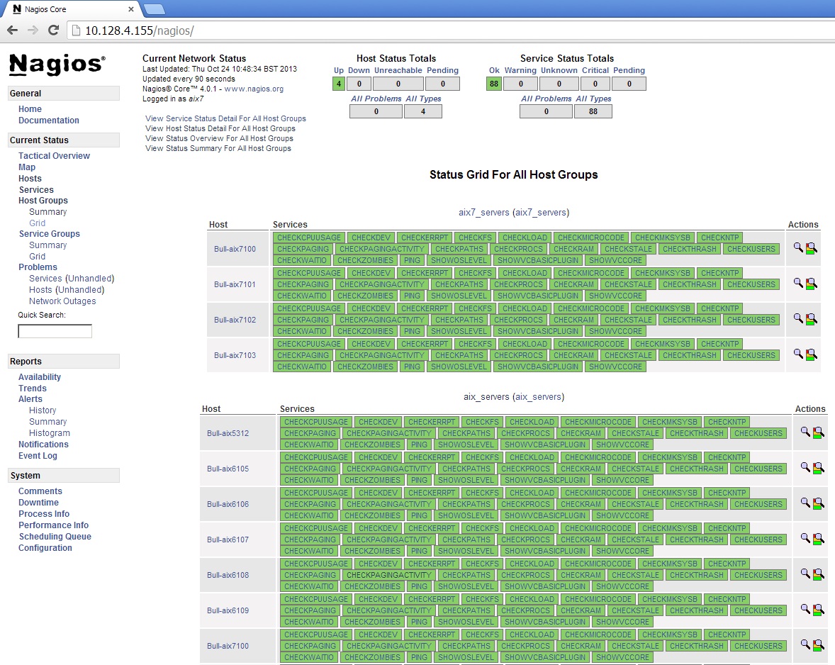

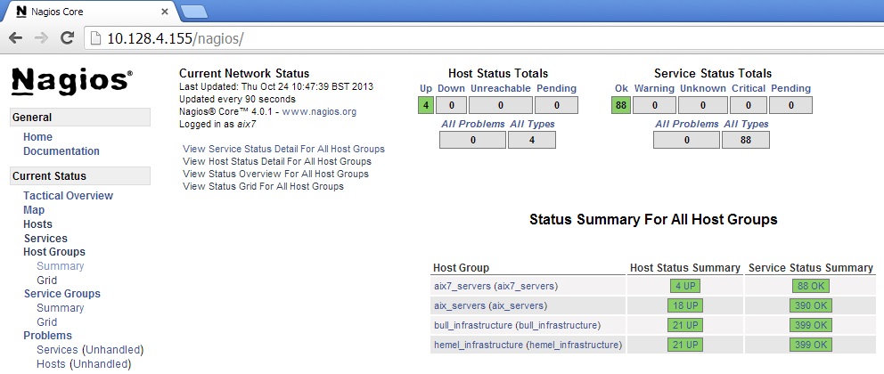

Postby MalcolmPreen » Thu Oct 24, 2013 5:14 am
Thanks - bug reported... http://tracker.nagios.org/view.php?id=519
I have also reproduced the issue using non-customer machines - see the attached screen shots
Example output from Hostgroups
Hostgroups / Summary shows total number of hosts/services... not total number of viewable hosts/services
Example output from Hostgroups/Summary
Hostgroups / Grid shows the names of all of the services... including those on non-viewable screens..
Example output from Hostgroups/Grid
Clicking on any of the links which shouldn't be viewable produces no data... but the host/service names should not be viewable.... IMHO
