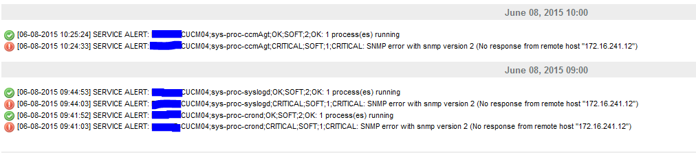

Hi lmiltchev
Deffinately, i can see lot of improvement so thank you on that.
But noticed the following/attached (given below is for one host as example) that after 9am i can see the following. (nothing between 12am - 09am) I could also see the similar for other host/services. I can think of if it could be due to intermittent packet loss on the network. I will run another ping test to see how this goes during the day.
- Skynet Drone
- Posts: 2620
Re: SNMP error with snmp version 1 (No response from remote
Or potentially the host is super busy and unable to process SNMP requests in time. Sounds ridiculous, but could very well be.
Are you monitoring this system's load?
- Posts: 28
- Joined: Sun May 31, 2015 3:02 pm
No packet loss found via continuous ping from nagios cli to the 3 hosts.
Load is not monitored, but will look into to put this in place.
Thank you both of you for tremendous support. I can say that 99% of the issue has been fixed.
