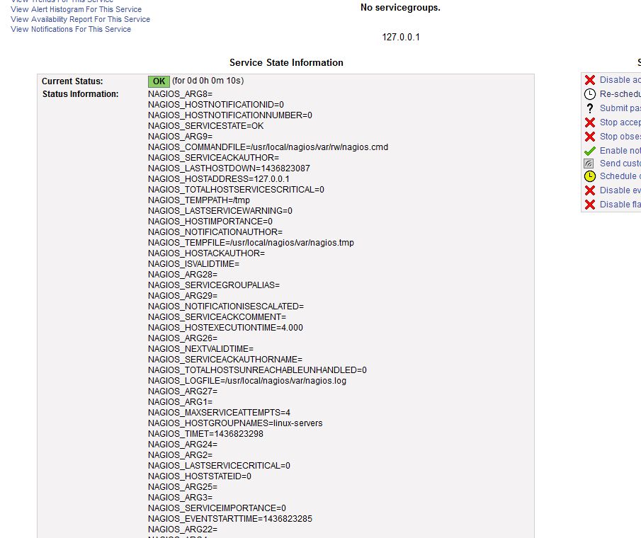

I'm not sure what broke for you, but if you don't have a lot of investment in the system already, I'd be happy to share my command history that got my system running. As a matter of fact I'll do it anyway.
I removed incorrect or unimportant lines for clarity's sake:
