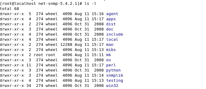

PolleroM
Posts: 24
Joined: Wed Aug 12, 2015 1:33 am
Re: Check_snmp
Post by PolleroM »
Result on attached
