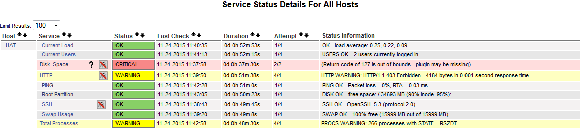

I am facing issues with NRDP server
I am suspecting it is not forwarding external commands to the nagios server
Below is the error i am getting for the respective service
(Return code of 127 is out of bounds - plugin may be missing)

NRDP --Return code of 127 is out of bounds

i am getting error (Return code of 127 is out of bounds - plugin may be missing) for all external commands
