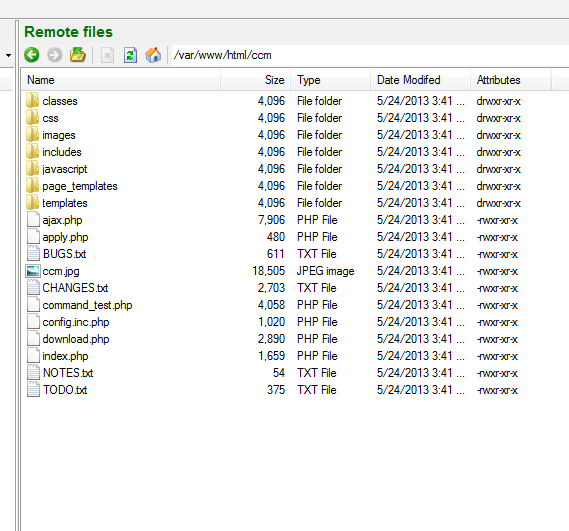

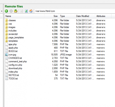

That directory does not exist in our install. Attached an image of what that directory looks like in our install.
CCM directory JHMR
CCM directory JHMR

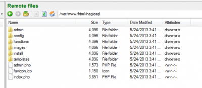

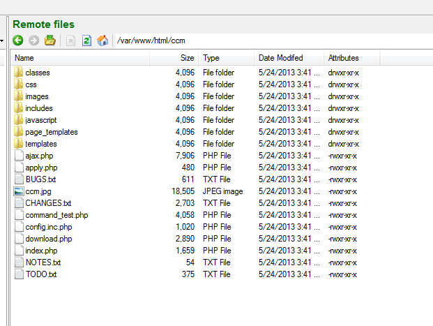

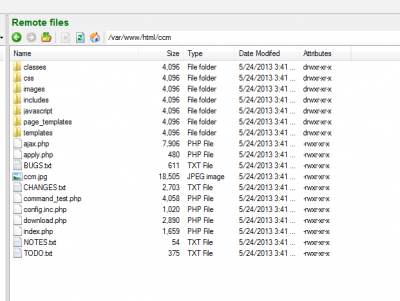

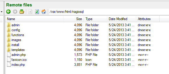

There is no ../html/CCM/Config/ directory in our install. However, I did find a config directory in ../html/nagiosql/. I am going to copy the /config directory to ../html/CCM and see what happens. Listed below are the permissions for that directory. Regarding documentation of the install procedure they used back in 2013, I don't have any.
Contents of ../html/nagiosql directory
../html/ccm directory
