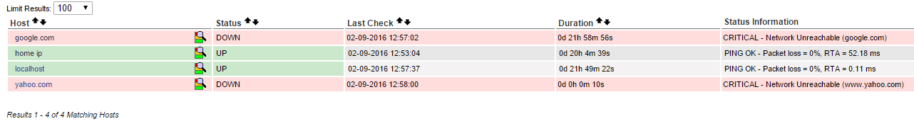

Done but both google.com and yahoo.com appear to be down even though I can ping both from the command line.

t3dus wrote:Done but both google.com and yahoo.com appear to be down even though I can ping both from the command line.
Added one of our company websites though and that works fine. Guess I don't care to monitor google.com and yahoo.com anyways but still weird why i can't.
