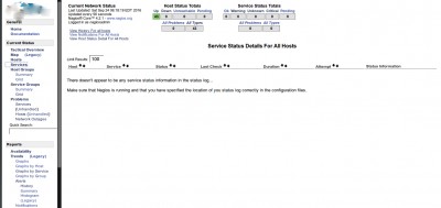

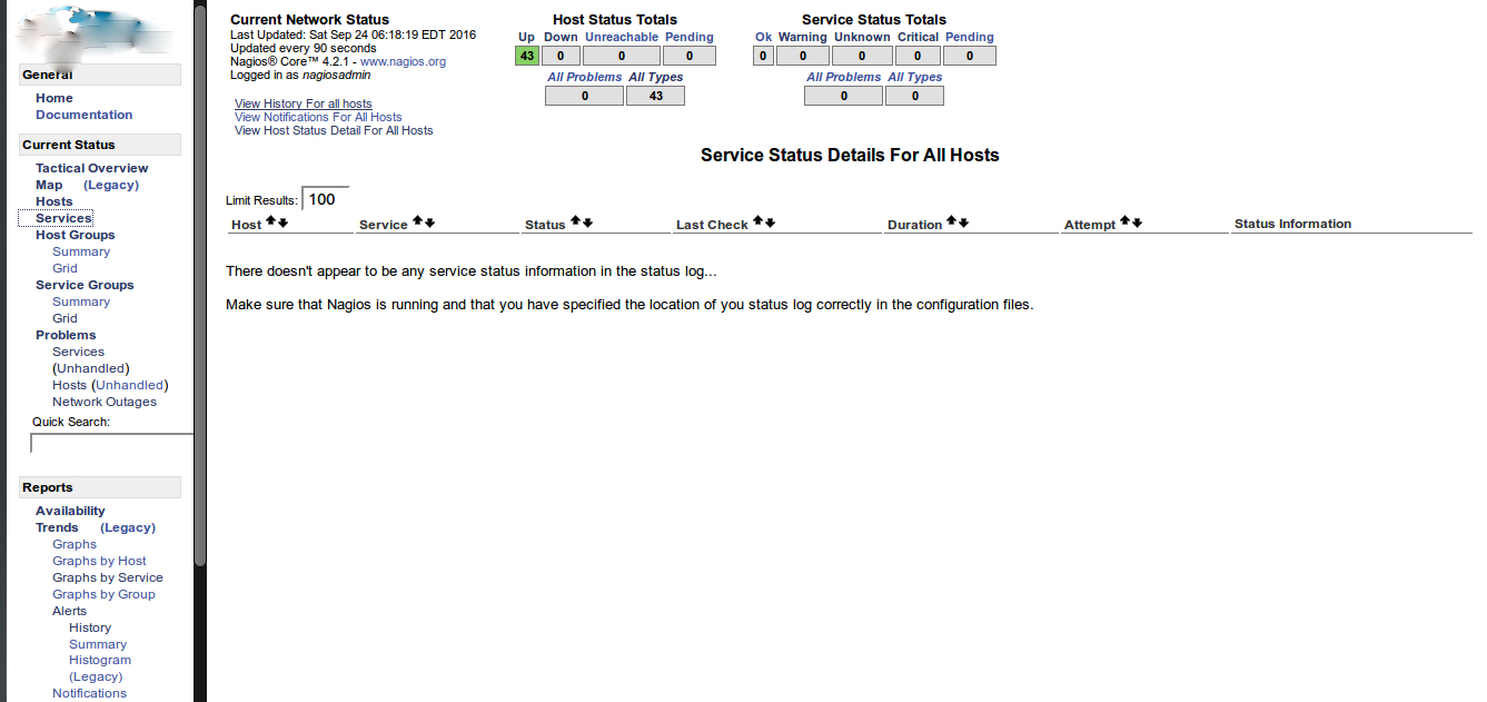

After upgradation i have frequently getting an error, please find screenshot.
During this error all critical and warning services goes green.
