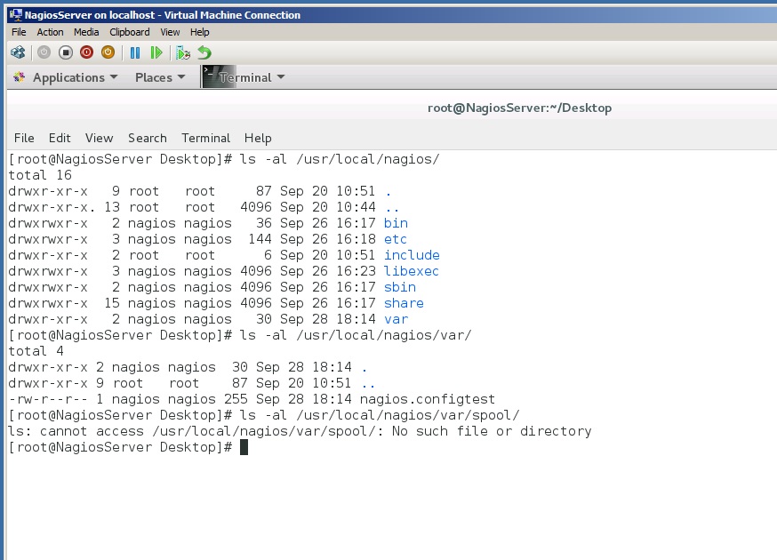

Absolutely yes.
After restarted the system this screenshot captured by me.
Re: Nagios Start FAILED
What guide did you follow when installing Nagios Core? I would run through it once again, as you're missing quite a few files / folders. See this article for our official document that explains the process - https://support.nagios.com/kb/article.php?id=96
