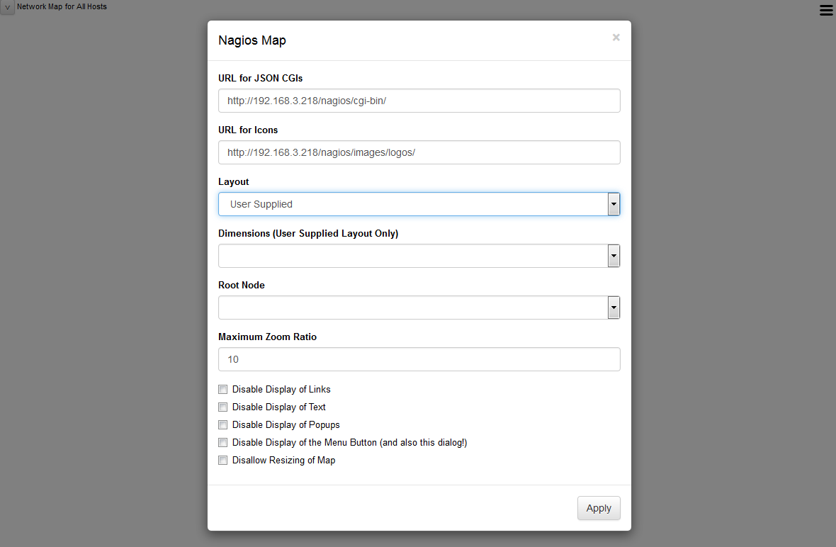

What version of Core are you using? Was it compiled from source or installed from distro repos? On what OS/version is nagios running? cat /etc/*-release may be of use.
Also, when you click on the menu in the upper right, do you have "User Supplied" selected as your Layout method? If not, what are you using? Thanks!

As you show in you screenshot, the 4.2.3 version offers to supply coordinates. But murphy is here..... the customer i try to supply with a functional map based on user coordinates is running the 3.5.1 version. The user coord map works, but all devices are plotted incorrect due to the incorrect offset
