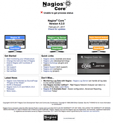

I am having the same issue, as described here. I have just updated following the instructions for upgrading Nagios Core 4 here https://assets.nagios.com/downloads/nag ... ading.html

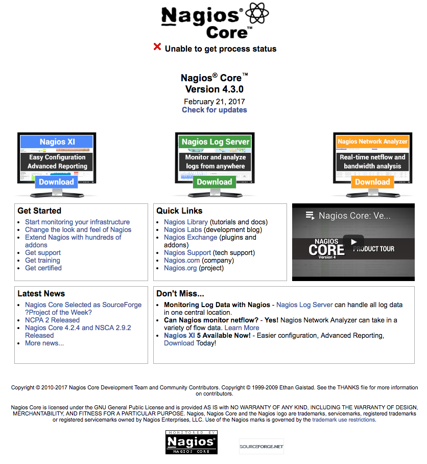

Main home page shows:
Unable to get process status

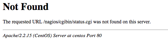

URL to any of the Current Status pages shows:
/nagios/cgibin/status.cgi was not found
Location of status.cgi shows:
location of status.cgi
Screen Shot 2017-02-22 at 10.38.46.png (10.69 KiB) Viewed 10231 times
Running Nagios on CentOS release 6.8 (Final).

It looks like we forgot to update that https://assets.nagios.com/downloads/nag ... ading.html page. See the UPGRADING file in the tar ball. I'll see about getting the web page updated.

Yes, it's related to #2. If you really don't want login/logout just add a ScriptAlias /nagios/cgibin "/usr/local/nagios/sbin" to the nagios.conf file.

It depends on what OS you are running, but some (potentially modified) version of the below. It's apache2 instead of httpd for Debian, for example. There's also no conf.d on Debian.
https://support.nagios.com/kb/article.php?id=96 hasn't been rewritten for 4.3.0, but it may help give you some clues depending on your OS. If you aren't comfortable with the apache configs on your OS, it might be wise to wait until we upgrade the documentation.
cd /etc/httpd/conf.d;
cp nagios.conf nagios.conf.bak
cd /<the nagios build directory>
make install-webconf
service restart httpd
Of course, we generally assume apache, but Core will run on other web servers. We just don't proviced instructions for those.
