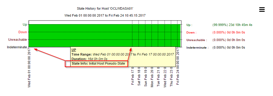

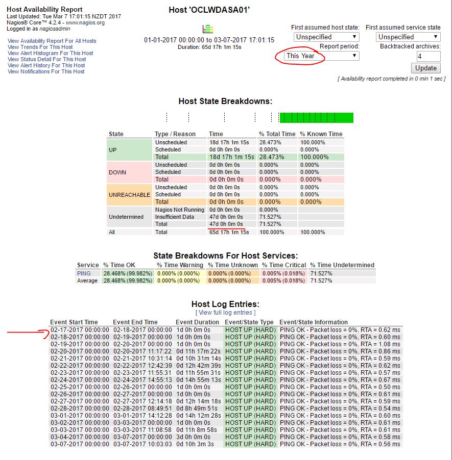

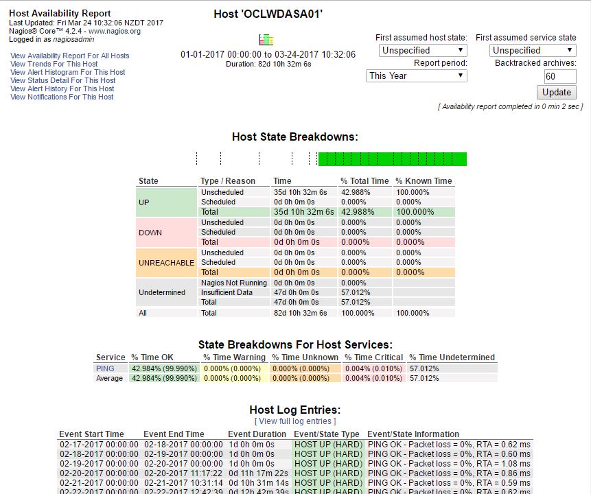

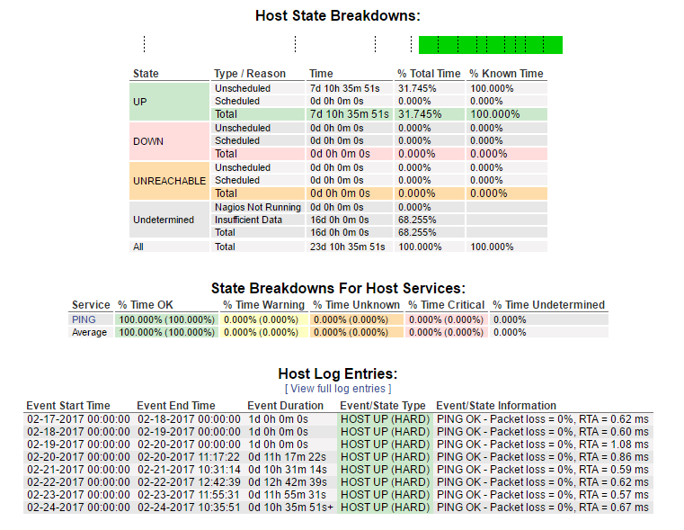

Here is the availability report for "This Month"
Here is the trend report for the same host, same time period.
Would really like to get these reports to be accurate. Thanks.

Didn't seem to help. I split the file with the following command
gawk -F"[][]" '{d=strftime("nagios-%m-%d-%Y-00.log", $2);print > d}' ~/test/nagios-02-17-2017-00.log
I've restarted nagios and tried running the reports again and getting the same issue.

Availability report
Availability report

Was the hostname ever changed? It's case-sensitive too.
Please attach the output of this command:
grep -l OCLWDASA01 /usr/local/nagios/var/archvies/*
Thank you

Try increasing the backtracked archives option in the report to like 10 or something and run it again, does that resolve the issue?
Thank you
jfla011
Posts: 5
Joined: Mon Feb 20, 2017 4:53 pm
Re: Availability reports and Trends incomplete data
Post by jfla011 »
No, sorry, doesn't help. It's strange, it seems to be broken for any reporting before February 17th, but seems to be working ok since then. February 17th is actually when I upgraded to 4.2.4 so I wonder if there was simply a reporting bug in my previous version.
