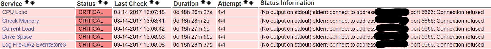

Now what worked with V 2.15 and the package installer fails:
No output on stdout) stderr: connect to address xx.xx.xx.xxx port 5666: Connection refused
connect to host xx.xx.xx.xxx port 5666: Connection refused
I'm not sure what is making it to fail....
