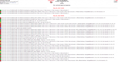

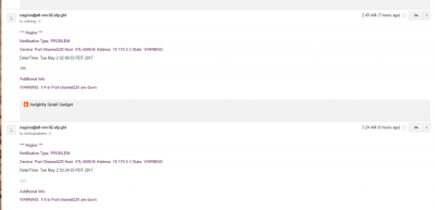

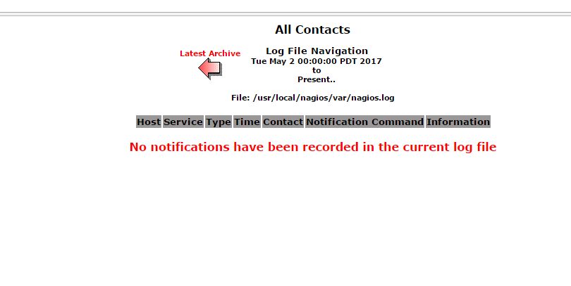

Also, event log doesnt have port-channel220 alerting at all
Here is notifications list for this day
dwhitfield wrote:I don't really know much about splunk but are you sure it's not splunk sending out the messages? Can you attach one of the emails with the headers for us to review. Also, can you attach any splunk logs?
Hello dwhitfield,
no we are not using splunk, you can see its commented out #
I will upload as a attachment
