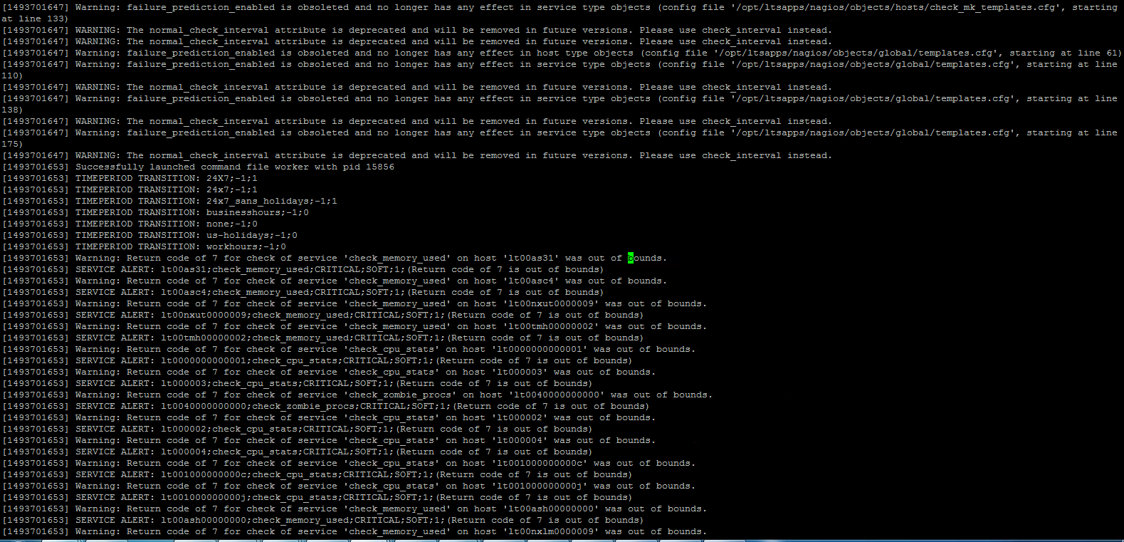

Hello all,
I have installed Nagios v.4.3.0 and at location /local/nagios/objects/hosts/hosts.cfg I have added 675 hosts and I can view all services on dashboard. But if I increase more hosts, say if I cross 684 I am getting an "Error: Return code of 7 is out of bounds" for all the services.
I have tried increasing following values in nrpe.cfg, but no luck,
connection_timeout=300 to 600
command_timeout=60 to 120
And I have following values in my nagios.cfg file
status_update_interval=10
check_external_command=1
command_check_interval=-1

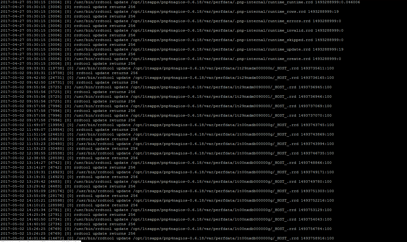

Below are in attachments,
nagios.log
perfdata.log
system ulimit -a

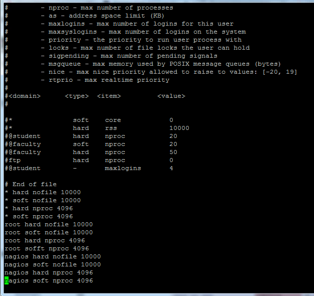

Posts: 9190
Re: ERROR: Return code of 7 is out of bond
It could be that you are hitting the number of open file limit on your server so lets increase it and see if that fixes the issue/
Edit the following file
/etc/security/limits.conf
Add the following lines to the end of the file:
* hard nofile 10000
* soft nofile 10000
root hard nofile 10000
root soft nofile 10000
Save if and see if the error is gone.
You may have to reboot the server for the changes to take affect.

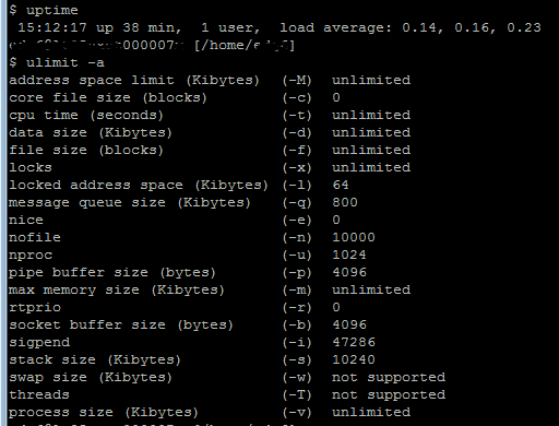

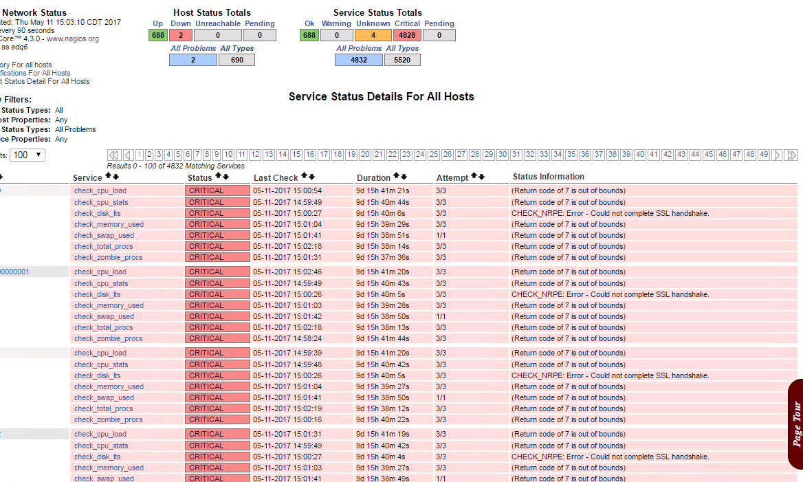

Thank you for the response and I have tried adding the value and rebooting the system, yet still see the issue. I have installed Nagios using puppet with default user defined as 'nagios' so added
"nagios hard/soft nofile 10000" (in picture attached) just to see if this picks up, but its not. Now I have added nproc value for both root and nagios to maximize processes and rebooted system. Yet no luck. Please find attachments. Thanks
Error I am seeing if I add more hosts greater than 684
ulimit -a
ulimit -a
sudo vi /etc/security/limits.conf

Here are the logs, at /opt/local/nagios/logs/nagios.log. (Not worring about ssl hand shake error). I have copied log where it is running right when they are 675 hosts and when I add more hosts to hosts.cfg and restart nagios service, I see the below logs.
[1494434722] SERVICE ALERT: rr00tm400000001;check_memory_used;CRITICAL;SOFT;1;CHECK_NRPE: Error - Could not complete SSL handshake.
[1494434730] SERVICE ALERT: rr00tm400000001;check_cpu_load;CRITICAL;HARD;3;CHECK_NRPE: Error - Could not complete SSL handshake.
[1494434745] SERVICE ALERT: rr00tm400000001;check_disk_rss;CRITICAL;SOFT;2;CHECK_NRPE: Error - Could not complete SSL handshake.
[1494434760] SERVICE ALERT: rr00tm400000001;check_swap_used;CRITICAL;HARD;1;CHECK_NRPE: Error - Could not complete SSL handshake.
[1494434767] SERVICE ALERT: rr00tm400000001;check_cpu_stats;CRITICAL;HARD;3;CHECK_NRPE: Error - Could not complete SSL handshake.
[1494434783] SERVICE ALERT: rr00tm400000001;check_memory_used;CRITICAL;SOFT;2;CHECK_NRPE: Error - Could not complete SSL handshake.
[1494434797] SERVICE ALERT: rr00tm400000001;check_total_procs;CRITICAL;SOFT;1;CHECK_NRPE: Error - Could not complete SSL handshake.
[1494434805] SERVICE ALERT: rr00tm400000001;check_disk_rss;CRITICAL;HARD;3;CHECK_NRPE: Error - Could not complete SSL handshake.
[1494434835] SERVICE ALERT: rr00tm400000001;check_zombie_procs;CRITICAL;SOFT;1;CHECK_NRPE: Error - Could not complete SSL handshake.
[1494434843] SERVICE ALERT: rr00tm400000001;check_memory_used;CRITICAL;HARD;3;CHECK_NRPE: Error - Could not complete SSL handshake.
[1494434858] SERVICE ALERT: rr00tm400000001;check_total_procs;CRITICAL;SOFT;2;CHECK_NRPE: Error - Could not complete SSL handshake.
[1494434895] SERVICE ALERT: rr00tm400000001;check_zombie_procs;CRITICAL;SOFT;2;CHECK_NRPE: Error - Could not complete SSL handshake.
[1494434906] Caught SIGTERM, shutting down...
[1494434906] Successfully shutdown... (PID=2016)
[1494434906] Event broker module 'NERD' deinitialized successfully.
[1494434907] livestatus: Socket thread has terminated
[1494434907] Event broker module '/opt/rssapps/check_mk/bin/livestatus.o' deinitialized successfully.
[1494434908] Warning: use_embedded_perl_implicitly is deprecated and will be removed.
[1494434908] Warning: enable_embedded_perl is deprecated and will be removed.
[1494434908] Warning: p1_file is deprecated and will be removed.
[1494434908] Warning: sleep_time is deprecated and will be removed.
[1494434908] Warning: external_command_buffer_slots is deprecated and will be removed. All commands are always processed upon arrival
[1494434908] Warning: command_check_interval is deprecated and will be removed. Commands are always handled on arrival
[1494434908] Nagios 4.3.0 starting... (PID=13720)
[1494434908] Local time is Wed May 10 11:48:28 CDT 2017
[1494434908] LOG VERSION: 2.0
[1494434908] qh: Socket '/opt/rssapps/nagios-4.3.0/var/rw/nagios.qh' successfully initialized
[1494434908] qh: core query handler registered
[1494434908] nerd: Channel hostchecks registered successfully
[1494434908] nerd: Channel servicechecks registered successfully
[1494434908] nerd: Channel opathchecks registered successfully
[1494434908] nerd: Fully initialized and ready to rock!
[1494434908] wproc: Successfully registered manager as @wproc with query handler
[1494434908] wproc: Registry request: name=Core Worker 13722;pid=13722
[1494434908] wproc: Registry request: name=Core Worker 13723;pid=13723
[1494434908] wproc: Registry request: name=Core Worker 13725;pid=13725
[1494434908] wproc: Registry request: name=Core Worker 13724;pid=13724
[1494434908] wproc: Registry request: name=Core Worker 13726;pid=13726
[1494434908] wproc: Registry request: name=Core Worker 13727;pid=13727
[1494434908] livestatus: Livestatus 1.2.6p16 by Mathias Kettner. Socket: '/opt/rssapps/nagios/var/rw/live'
[1494434908] livestatus: Please visit us at http://mathias-kettner.de/
[1494434908] livestatus: Hint: please try out OMD - the Open Monitoring Distribution
[1494434908] livestatus: Please visit OMD at http://omdistro.org
[1494434908] livestatus: Warning: environment_macros are enabled. This might decrease the overall nagios performance
[1494434908] livestatus: Cannot open log archive '/var/log/rssapps/nagios/archives'
[1494434908] livestatus: Finished initialization. Further log messages go to /var/log/rssapps/nagios/livestatus.log
[1494434908] Event broker module '/opt/rssapps/check_mk/bin/livestatus.o' initialized successfully.
[1494434908] Warning: failure_prediction_enabled is obsoleted and no longer has any effect in host type objects (config file '/opt/rssapps/nagios/objects/hosts/check_mk_templates.cfg', starting at line 64)
[1494434908] Warning: failure_prediction_enabled is obsoleted and no longer has any effect in service type objects (config file '/opt/rssapps/nagios/objects/hosts/check_mk_templates.cfg', starting at line 133)
[1494434908] WARNING: The normal_check_interval attribute is deprecated and will be removed in future versions. Please use check_interval instead.
[1494434908] Warning: failure_prediction_enabled is obsoleted and no longer has any effect in host type objects (config file '/opt/rssapps/nagios/objects/global/templates.cfg', starting at line 61)
[1494434908] Warning: failure_prediction_enabled is obsoleted and no longer has any effect in service type objects (config file '/opt/rssapps/nagios/objects/global/templates.cfg', starting at line 110)
[1494434908] Warning: failure_prediction_enabled is obsoleted and no longer has any effect in service type objects (config file '/opt/rssapps/nagios/objects/global/templates.cfg', starting at line 138)
[1494434908] Warning: failure_prediction_enabled is obsoleted and no longer has any effect in service type objects (config file '/opt/rssapps/nagios/objects/global/templates.cfg', starting at line 175)
[1494434914] Successfully launched command file worker with pid 13737
[1494434914] TIMEPERIOD TRANSITION: 24X7;-1;1
[1494434914] TIMEPERIOD TRANSITION: 24x7;-1;1
[1494434914] TIMEPERIOD TRANSITION: 24x7_sans_holidays;-1;1
[1494434914] TIMEPERIOD TRANSITION: businesshours;-1;1
[1494434914] TIMEPERIOD TRANSITION: none;-1;0
[1494434914] TIMEPERIOD TRANSITION: us-holidays;-1;0
[1494434914] TIMEPERIOD TRANSITION: workhours;-1;1
[1494434914] Warning: Return code of 7 for check of service 'check_cpu_stats' on host 'rr005005' was out of bounds.
[1494434914] Warning: Return code of 7 for check of service 'check_memory_used' on host 'rr00as54' was out of bounds.
[1494434914] Warning: Return code of 7 for check of service 'check_total_procs' on host 'rr00nxasi000002' was out of bounds.
[1494434914] Warning: Return code of 7 for check of service 'check_cpu_stats' on host 'rr006003' was out of bounds.
[1494434914] Warning: Return code of 7 for check of service 'check_swap_used' on host 'rr0090000000006' was out of bounds.
[1494434914] Warning: Return code of 7 for check of service 'check_total_procs' on host 'rr00nxas0030000' was out of bounds.
[1494434914] Warning: Return code of 7 for check of service 'check_total_procs' on host 'rr00nxdm0010000' was out of bounds.
[1494434914] Warning: Return code of 7 for check of service 'check_swap_used' on host 'rr00nxdx00a0000' was out of bounds.
[1494434914] Warning: Return code of 7 for check of service 'check_total_procs' on host 'rr005003' was out of bounds.
[1494434914] Warning: Return code of 7 for check of service 'check_cpu_stats' on host 'rr00m0000000005' was out of bounds.
[1494434914] Warning: Return code of 7 for check of service 'check_total_procs' on host 'rr00nxdt0020007' was out of bounds.
[1494434914] Warning: Return code of 7 for check of service 'check_swap_used' on host 'rr00nxut000000x' was out of bounds.
[1494434914] Warning: Return code of 7 for check of service 'check_swap_used' on host 'rr00tm100000002' was out of bounds.
[1494434914] Warning: Return code of 7 for check of service 'check_cpu_stats' on host 'rr00nxas0000006' was out of bounds.
[1494434914] Warning: Return code of 7 for check of service 'check_total_procs' on host 'rr00nxas00j100a' was out of bounds.
[1494434914] Warning: Return code of 7 for check of service 'check_total_procs' on host 'rr00nxdx0010004' was out of bounds.
[1494434914] Warning: Return code of 7 for check of service 'check_swap_used' on host 'rr00nxtt0050000' was out of bounds.
[1494434914] Warning: Return code of 7 for check of service 'check_swap_used' on host 'rr00nxtti000000' was out of bounds.
[1494434914] Warning: Return code of 7 for check of service 'check_swap_used' on host 'rr00nxut000000a' was out of bounds.
[1494434914] Warning: Return code of 7 for check of service 'check_memory_used' on host 'rr0050000000007' was out of bounds.
[1494434914] Warning: Return code of 7 for check of service 'check_cpu_stats' on host 'rr00nxam0000004' was out of bounds.
[1494434914] Warning: Return code of 7 for check of service 'check_cpu_stats' on host 'rr00nxam0010000' was out of bounds.
[1494434914] Warning: Return code of 7 for check of service 'check_cpu_stats' on host 'rr00nxas0f0f000' was out of bounds.
[1494434915] Warning: Return code of 7 for check of service 'check_memory_used' on host 'rr00ase0' was out of bounds.
[1494434916] Warning: Return code of 7 for check of service 'check_memory_used' on host 'rr007002' was out of bounds.
[1494434916] Warning: Return code of 7 for check of service 'check_cpu_stats' on host 'rr00f0000000002' was out of bounds.
[1494434916] Warning: Return code of 7 for check of service 'check_cpu_stats' on host 'rr00nxdt0050001' was out of bounds.
[1494434918] Warning: Return code of 7 for check of service 'check_zombie_procs' on host 'rr0050000000000' was out of bounds.
[1494434918] Warning: Return code of 7 for check of service 'check_total_procs' on host 'rr00tm400000001' was out of bounds.
[1494434918] SERVICE ALERT: rr00tm400000001;check_total_procs;CRITICAL;HARD;3;(Return code of 7 is out of bounds)
[1494434921] Warning: Return code of 7 for check of service 'check_cpu_stats' on host 'rr00nxdb0000002' was out of bounds.
[1494434922] Warning: Return code of 7 for check of service 'check_memory_used' on host 'rr001000000000l' was out of bounds.
Posts: 9190
Nothing is showing up in those logs as a possible cause except check these errors from the nagios.log file.
I do see that the server has pnp4nagios and livestatus running. You may want to disable those and see if the error goes away.
You also may want to check the log files for them and see if there are any errors in them.
