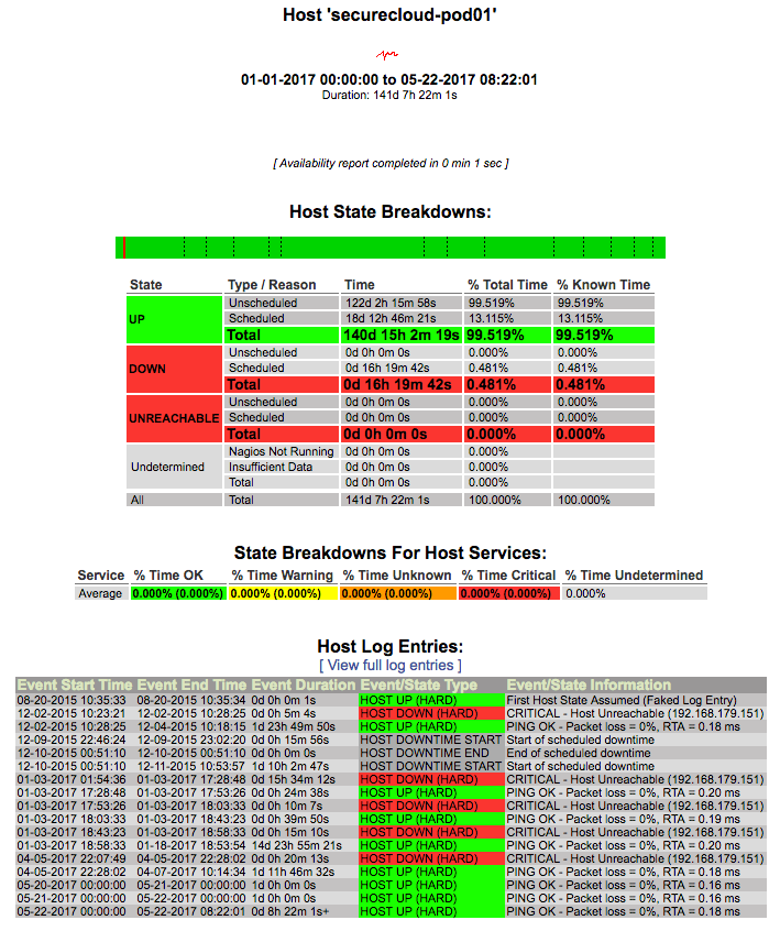

2. Same thing, except changed Time Period to "This Year"
    ok, now I get something other than %100 which is what we want and expect. Up is 99.508% (137d 16h 51m 54s) Down is .492% (0d 16h 19m 42s) The Host Log Entries outside of the report period persists, but include the January and early April down time---- take note.

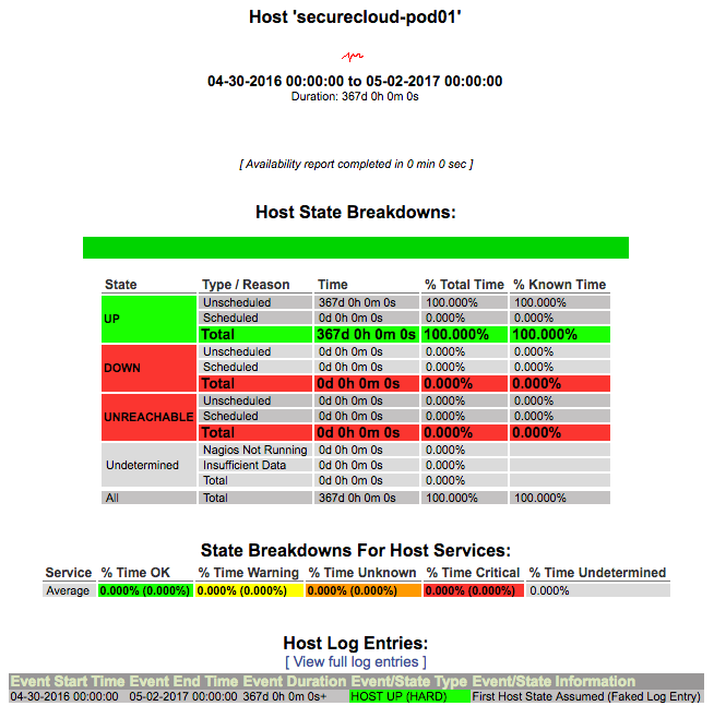

3. Changed time period to "Custom" . 5-1-2016 to 4-30-2017
    Here's the problem- Up 100%, Down 0%, Nothing in host log entries

So if we know the host was down in January and early April of this year (see #2), and that time range is included in the Custom Report time range, why does the report show uptime of 100%, and also not show the host log entries like it did before.

Report for April 30 2016 through May 1 2017 - should include data from "This year" - not correct..
Report for "This year" - looks correct

When you ran the report using the custom time period, it looks at the archived log file in that time frame by the time stamp of the files, but since you do not have any files in that time frame, it is showing you that the host it up because the First Assumed Host State setting was set to UP.
