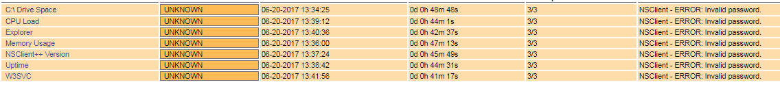

In one of your earlier posts, you said that you were getting the following error
NSClient - ERROR: Invalid password.
Where are you seeing that error and can you provide a screen capture of the error?
Have you created and service check commands on the Nagios server to check that windows host?
If so, you would edit those configs and change the password there.

Re: NSClient++
The windows.cfg file only has the host checks and not the service checks.
That is not the file you will have to edit, but it should be in the /usr/local/nagios/etc/objects/ folder.
One way to find the correct file is to grep for one of the service descriptions that are having the error. Use this example below.
The output of the grep should show you the file you will have update the NSClient password.
One thing you should do is keep track of the files you are editing so if you have to change something, you know what was done, and when it was done.
grep -R "CPU Load" /usr/local/nagios/etc/

Re: NSClient++
Open those files, find the password and change it to the same password that you set in the nsclient.ini file.

Re: NSClient++
Take a look at this link.
https://assets.nagios.com/downloads/nag ... ndows.html
Especially the section called "Password Protection". It explains where to put the password in the nagios config files that is used in the nsclient.ini file.

Re: NSClient++
You need to give us the full config. It looks like you are just giving us what is showing on the screen at a particular time.
The following should aid you in your search:
grep -n check_nt /usr/local/nagios/etc/objects/commands.cfg
grep -n check_nt /usr/local/nagios/etc/objects/windows.cfg

Re: NSClient++
found it. See below.
command_name check_nt
command_line $USER1$/check_nt -H $HOSTADDRESS$ -p 12489 -s AtL@NT15 -v $ARG1$ $ARG2$
That is the old password I will add the new one there then restart the nagios server. I will let you know. I remember doing this before just couldn't remember where it was done at.
