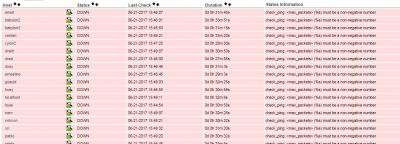

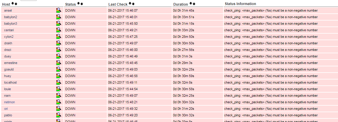

For some reason I am seeing the following on my console. I did not change anything, this is a new install and it was fine, but now I am seeing this error message
check_ping: <max_packets> (%s) must be a non-negative number
I have attached it as well..

Can you share your check_ping command definition, one of the problematic host definitions, and any host templates that might be used for the hosts that are experiencing this issue?
The message you are seeing is exclusive to a non-positive number being provided via the -p argument to the check_ping plugin:
case 'p': /* number of packets to send */
if (is_intnonneg (optarg))
max_packets = atoi (optarg);
else
usage2 (_("<max_packets> (%s) must be a non-negative number\n"), optarg);
break;
