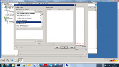

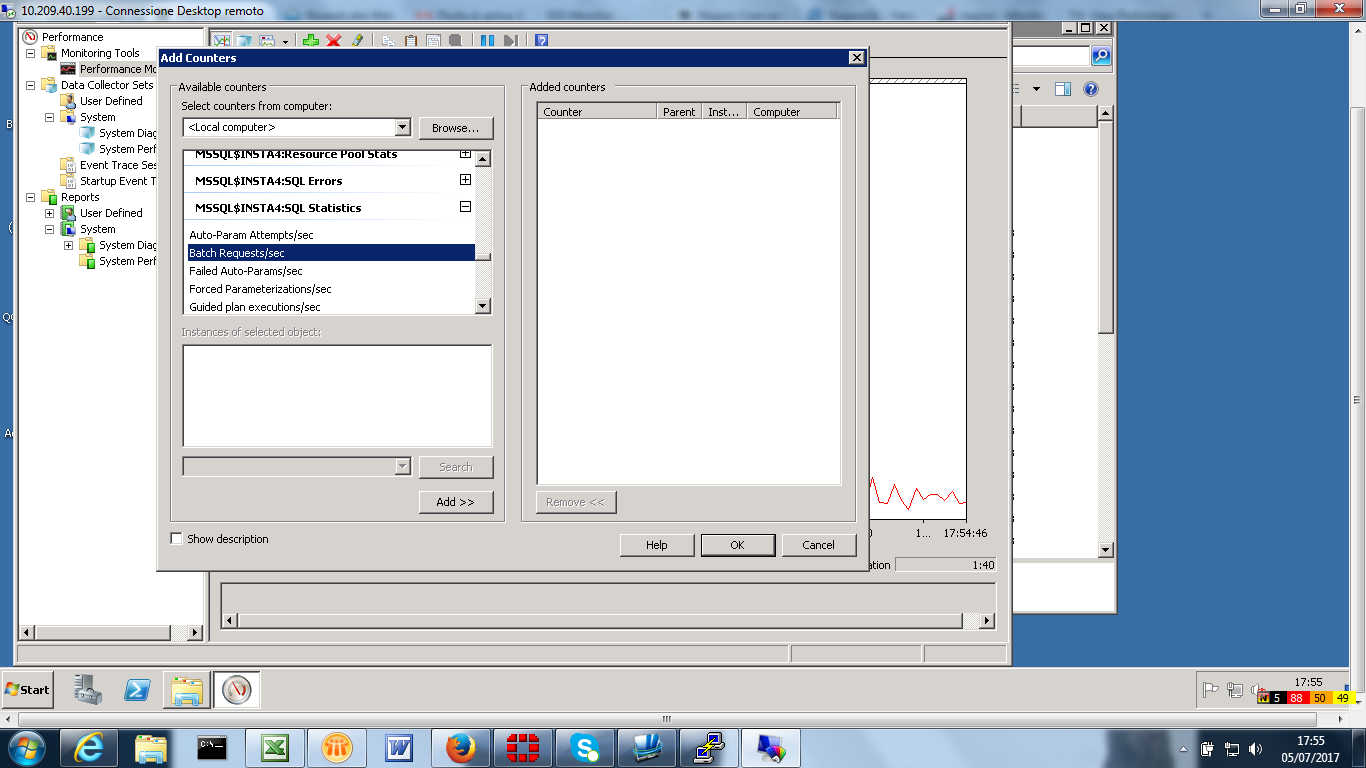

I attach an image where you can see how is defined the counter on the server
why I got the error ?
