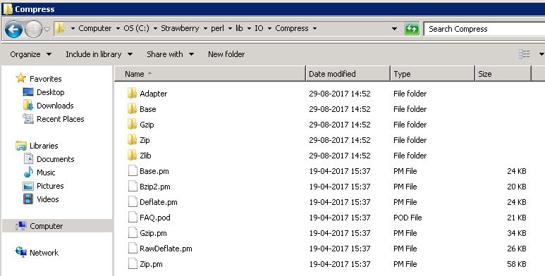

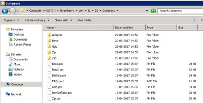

The error looks like a Perl Module is missing on the Windows server so can you post the contents of this folder on the Windows Server?
C:\Strawberry\perl\lib\IO\Compress

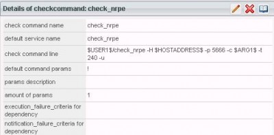

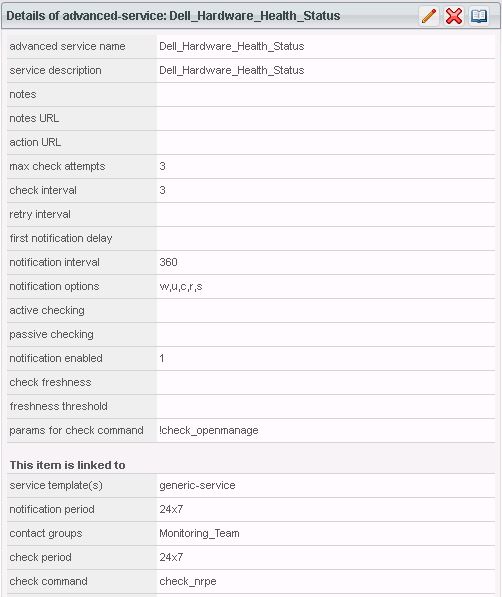

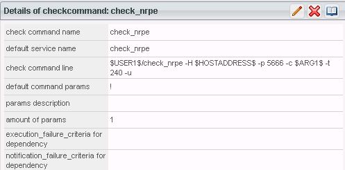

Can you post how the service check and the command is defined on the Nagios server?

@ tgriep
Please find the screenshot of the contents in Compress directory attached.
Also find the details of how service has been configured.
Attaching the check_command and service configuration details also
Dell hardware health check service
check_command_nrpe
check_command_nrpe
Contents of  Compress Directory
